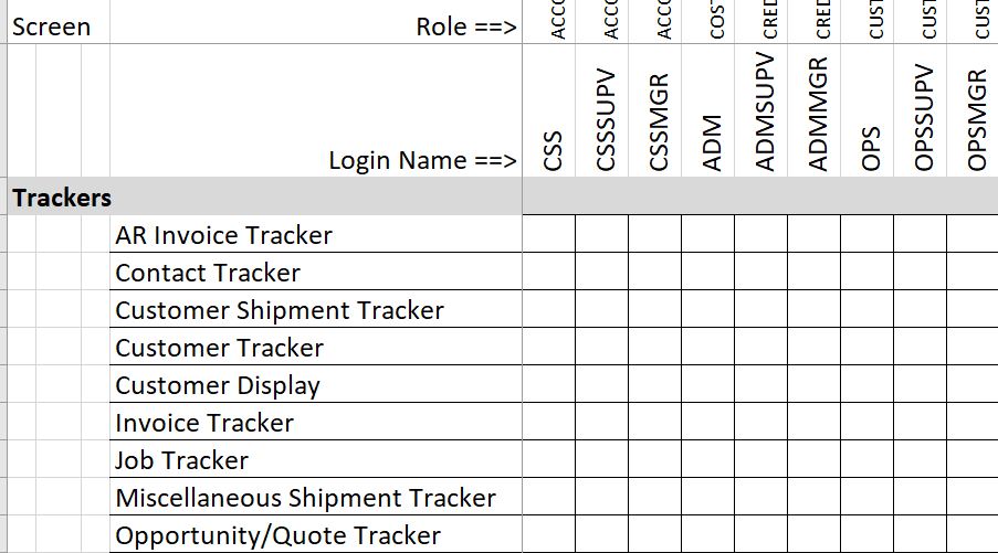

Has anyone come up with a good way to get an electronic list of menu items by menu area? The idea is to get a list that mirrors how it looks in E10 without manually keying them all in. Doing some searching of past posts, it seems one of the issues is limiting the list to just the licensed items, and then getting it to show the parent menu with the sub-items below (like in Menu Maintenance). Anyone have a solution they can share?

Here’s a snip of the Excel sheet where I want to load the menu items:
I think one of the other things that needs to be considered is the fact that the same menu item (name) can exist in different parts of the menu structure. Your spreadsheet doesn’t appear to show that.
This is just a snip of the spreadsheet. The multiple locations of a specific menu items is reflected in the full spreadsheet. The problem I am having is being able to export/download a list of all the menu items in the order the appear in Menu Maintenance.

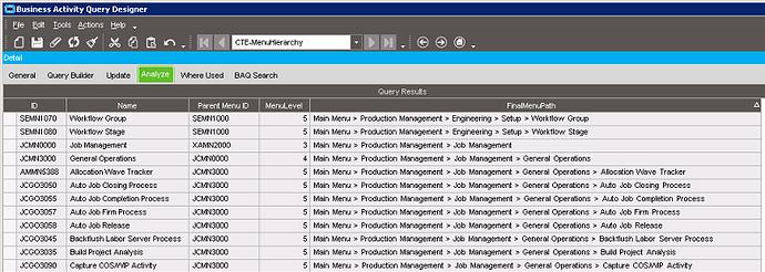

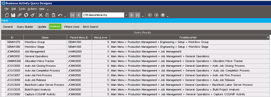

This can be done fairly easy with a CTE BAQ on the Menu table. I have a BAQ that i have created multiple times as a training experience for CTE queries. Here are the results… the query demonstrates multiple CTE Features, such as appending fields (building Menu Path), Indention, and sorting into the correct order (for things like Explosion of data like this).

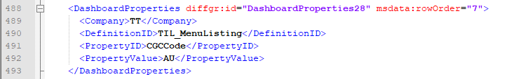

Thanks for the responses and suggestions! I will try @Hally’s dashboard, adjusting the country section as @amurdock advised, and also see if I can put together a BAQ like @timshuwy showed. Sure will be nice to have a non-manual entry way to do this…
There is a good example of a CTE baq in the tools guide. Mine was based on that and another post about menu security. I put detail on the notes of the dashboard.
