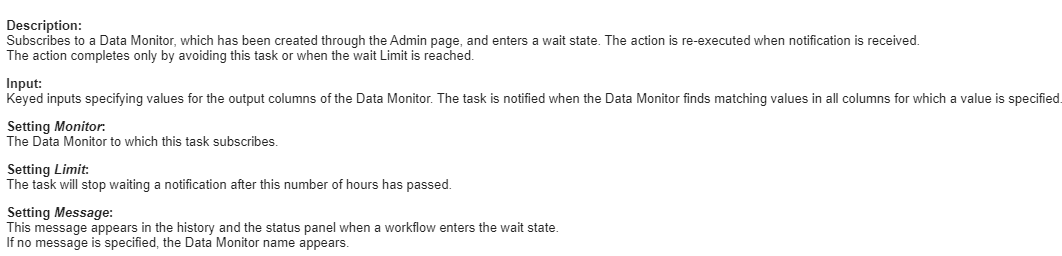

Oh, I don’t think I was aware that there was a new task associated with the Data Monitor… I’ll have to look into that more to have a better understanding of how it works. I’m assuming that the screenshot you attached isn’t the actual Wait For Data task you’re using, correct? I only ask as it looks like the fields are blank.
It is, but only because I’m interested in one value only (Quantity). It’s up off the top of the screenshot.
This is the whole thing. All the values are inputs, rather than the outputs you see on a DataLink task. I figured I’d only need the one value I’m interested in since they’re inputs.
I’ve added the screenshot of the description for this task as I think the answer may lie in the “Input” section. If not the answer, then perhaps the next thing to look into. Based on my interpretation of what it states, it would seem to me that the “$Field.Quantity” you have populated in your Wait For Data task is going to be evaluated against the PO value quantities and only once they match will the workflow move on. Is this the intent of what you’re looking to do or you just want to move on when any value is populated into the quantity field?
