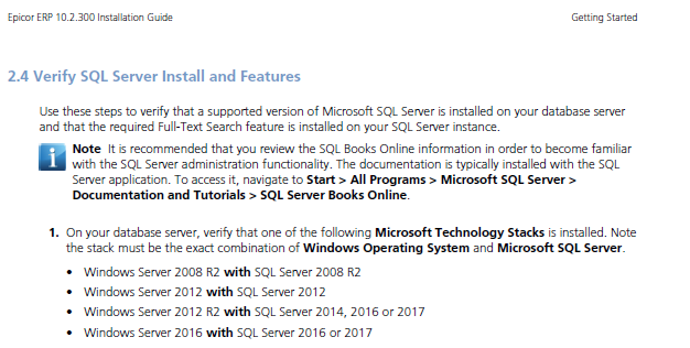

We are currently running ERP10.1.600 on Windows 2012 R2 with SQL 2016. We are getting ready to build another VM for our upgrade to 10.2.300 but we were wondering what some of the major benefits (from an Epicor point of view) would be to running on Windows 2016 and SQL 2017? Looking for reasons to justify the upgrade costs otherwise we would just continue to use Windows 2012 R2 and SQL 2016 for ERP10.2.300 as it looks like those are still approved stacks for this version:

Server 2012 R2 is no longer in mainstream support. Really depends on the industry you are in and how critical things like regulatory compliance (SOX, ISO27001 etc) and patching need to be in your organization. There will be organizations who will be obligated to run a critical business system like Epicor only on os’s that are on mainstream support but plenty more who where this is a best practice but not an obligation.

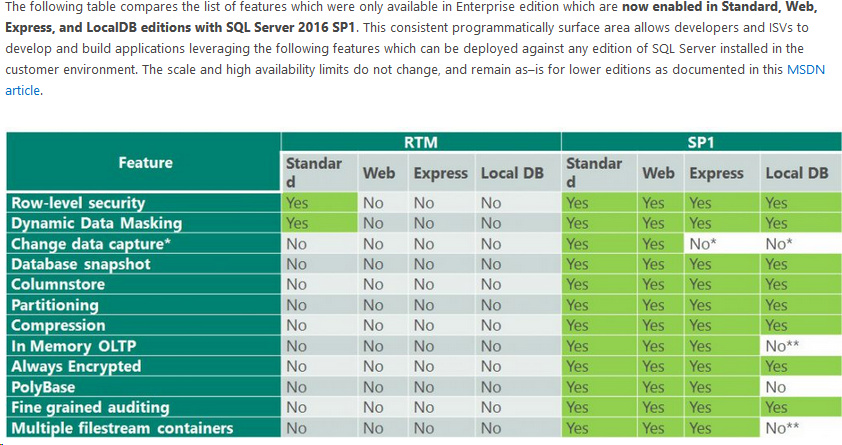

SQL Server 2016 licensing changes added a lot of bells and whistles that we you can reach out for ‘for free’ that used to be in the Enterprise SKU -
This has some propellers spinning about some things but there is nothing short term coming to market that I am aware of that will require ‘Enterprise 2012 / Standard 2016’. If you are going thru the pain to jump from End of Life 2008, I’d heavily consider skipping 2012 but other than that, nothing we will require safe harbor, forward looking statement, etc etc
Do the math, review the new toys you get in standard now that can help you operationally.
