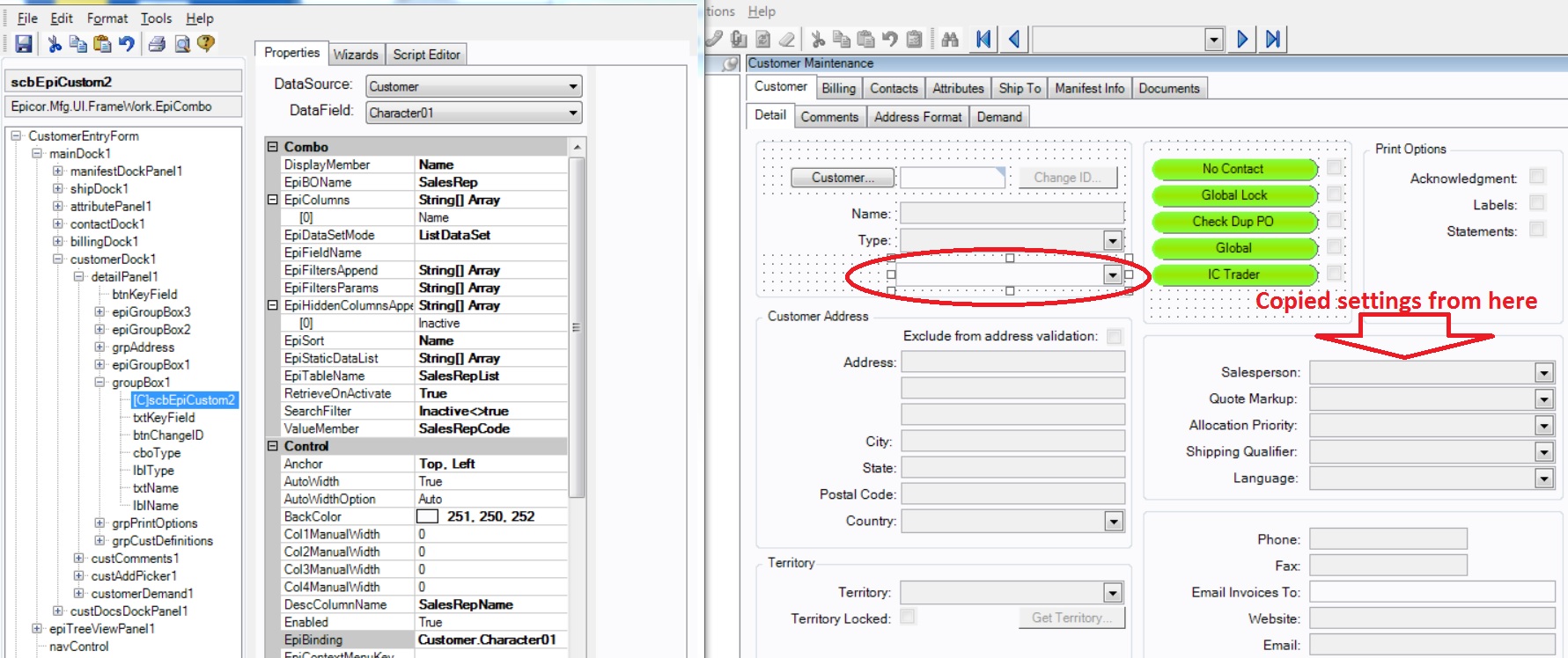

So next I thought I would try a ComboBox - I ended up copying the settings from the existing Salesperson dropdown to a new Combo Box control and bound it to Customer.Character01 - and it kind of works. When I call up a customer both controls show the same salesperson name. They appear to be in Sync even though one is bound to Customer.Character01.

However, what is happening now is that my new dropdown that is bound to Customer.Character01 seems to be in sync with the Epicor field SalesPerson. Whenever I update my new control to Person1 the Epicor SalesPerson field also changes to Person1.
The bindings are different - but the controls appear to be connected.

Have you already tried changing the DescColumnName for your custom EpiCombo?
e.g. ShortChar01 (if it isn’t already in use)?
