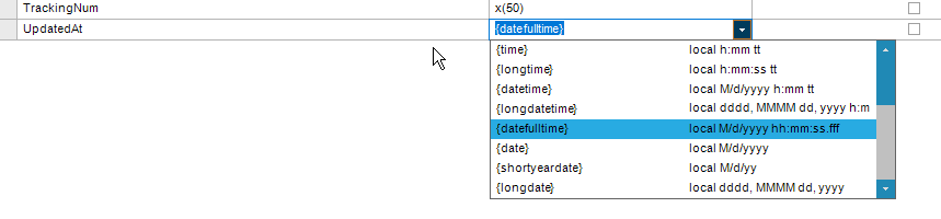

So we have an app writing a date time in UTC time, which I get. However, we will have to translate that to usable local times. Is there a standard/built in way to do this? Or is this an offset thing. I see the BAQ has local in the format, but they all say that. Should my app be writing in Local time or UTC?
