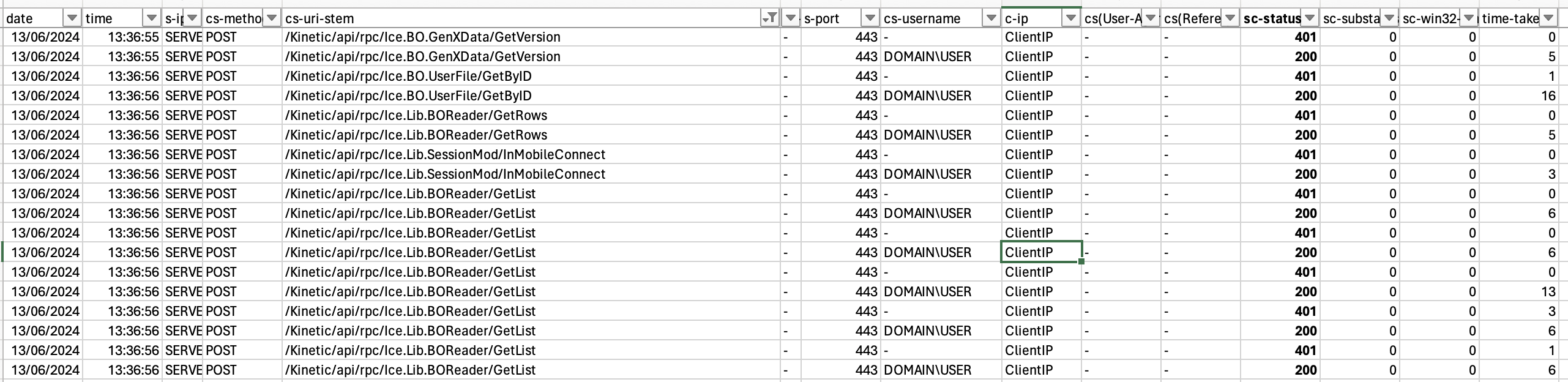

Looking at the IIS Logs we see the following:
As you can see you get a call without a cs-username which gets a 401, immediately followed by a call with it - which gets a proper response.
While this might seem somewhat trivial, the roundtrip time (viewed in the client traces), shows increases from circa 40ms to 120ms. In cases where customisations are calling multiple business objects (to populate additional line item information for example), this additional time can quickly add up, and should be avoidable.
