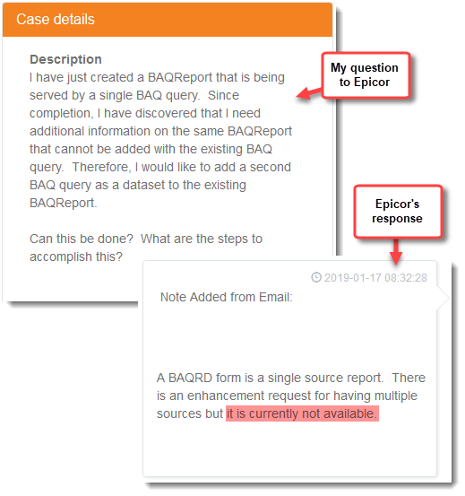

I have a follow-up question for you concerning “different datasets of an SSRS report in E10”. If I understood correctly, you were able to pull in more than one dataset into your report solution. Are your datasets Epicor BAQ based, or are they derived from physically writing the SQL directly into in the query textbox, or perhaps from a stored procedure?
I had recently asked EpicCare about using two separate BAQs to define separate datasets on the same RDL and they said (for v10.1.400.14) that it cannot be done:
Assuming you are using v10.2.XXX in your environment, does that version allow a developer to pull in more than one BAQ, or is your situation more accurately described as creating multiple datasets from SQL statements being entered directly into the RDL? Or, did I not receive accurate information, perhaps, from EpicCare?

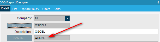

With regards to BAQ reports in 10.2.300.5: the BAQ report designer doesn’t allow selecting more than one query. You can modify BAQ reports through Report Data Definitions, however, and there is a “New BAQ” option. I tested it and the system did allow me to add two different reports. While I’m not sure that it will actually work, the functionality does appear to be there.
