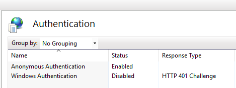

I would check the IIS settings for the instance. Is the windows authentication turned on?
I meant to ask this at insights :sob:
I’ll go check.
I am assuming it is turned on since it allows me to login when specifying the domain (which is windows auth).
Yes ours is enabled.
