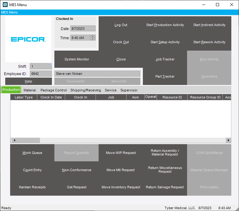

If you are on-prem (and it looks like you are), and the user has Change Password privileges on their User Account, then have them right-click on the Epicor logo (top left of the window). There should be a “Change Password” option in the context menu dropdown.
This is the Classic MES window, @SueLowden gave you the Kinetic instructions.

In the Classic desktop client, you go to the Settings window. In the Kinetic desktop client, you click on the person icon lower left and select the Settings button.
But there is no access to Settings in EITHER Classic MES nor Kinetic Data Collection.
Probably need to open a Support Case at this point… but my guess is that it’s “working as designed”. Within the MES/Data Collection program, user security is much more dependent on the logged-in Emplolyee ID, and often the Epicor UserID is generic and shouldn’t be able to be changed by the shop floor operators. That’s my guess… good luck!
