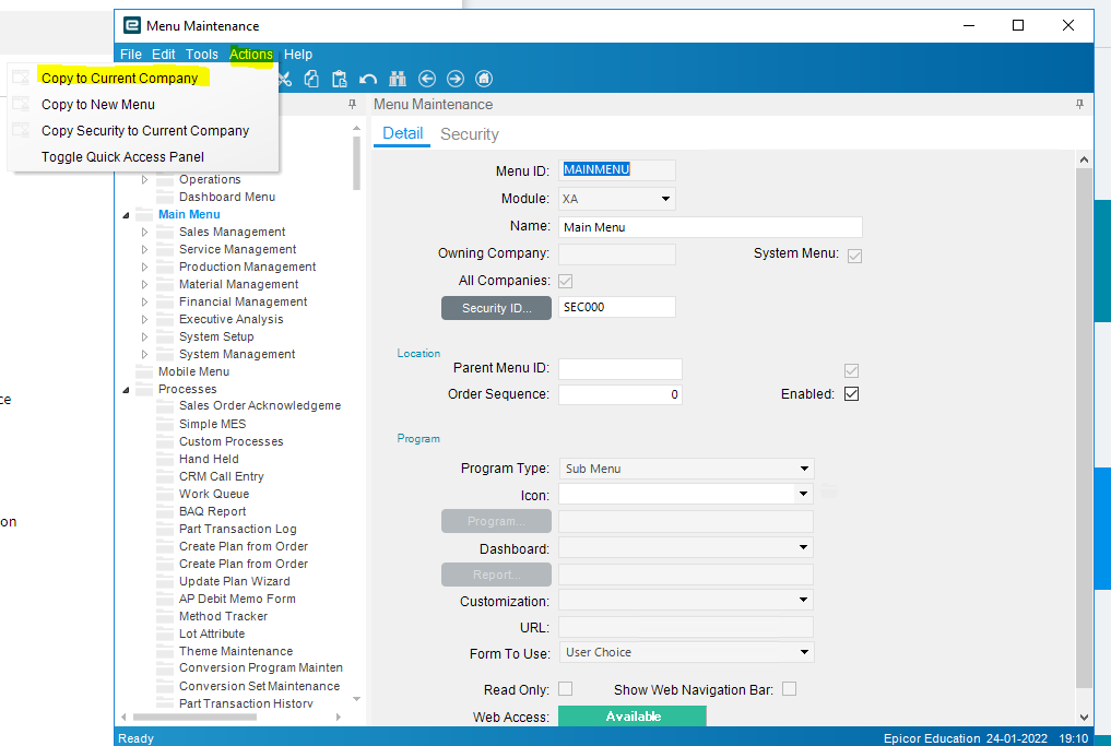

Always use the below option ‘copy to the current company’ to add customization.
The menu id and Security id will remain the same and it will allow you to add the Customization layer.

@Ricky90 You don’t have to disable the original menu. When you run ‘Copy to Current Company’ you will see the duplicate menu item on the tree on the left. When you save Menu Maintenance and refresh you will now only see the Current Company menu item (ie. Owning Company will be populated.
