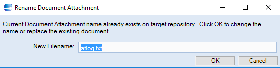

Not sure in E10, but in E9 there is a client config item for duplicate file attachments. If you have a file that is already an attachment, like drawing1.dmg for example and a user wants to attach a different file to a different job/case/whatever with the same name the system should prompt asking to overwrite or rename the file. This can lead to files being overwritten by mistake.
The DuplicateAttachmentMode value in client config file should help.he user can overwrite the file and nobody will know. By default it is set to Prompt I recall, AutoDateStamp appends an encoded of the filename in brackets eg. atlog(636350448145141803).txt as distinct from the previously saved file atlog.txt. Not to mention remove another unnecessary mouse click.
Prompt shows something like.
I hope someone finds this useful, if anyone can confirm if this is in E10 even better.
It is still available in E10. Inside the client folder open the ConfigEditor.exe or edit the sysconfig manually. Somewhere towards the bottom is DuplicateAttachMode:AutoDateStamp/Prompt.
