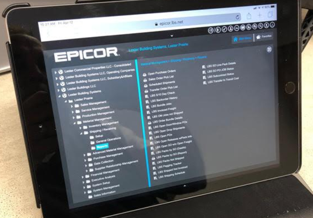

Yes - You need to get Epicor Web Access Deployed and then Configure your server to be accessible from the Internet.
EWA on an iPad is very workable.

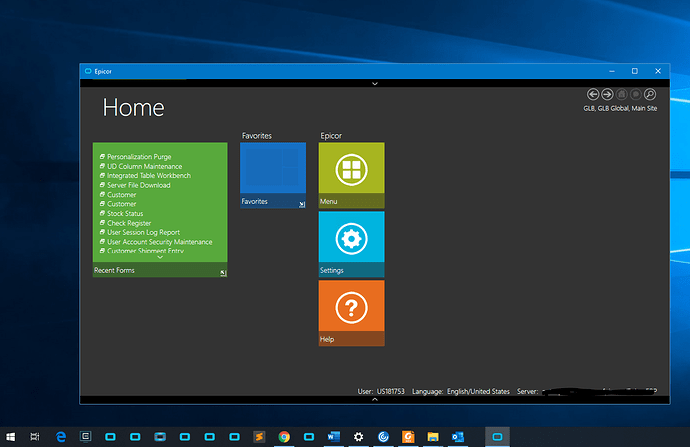

We use Citrix or any RDP Solution like it should and will work. We have plenty of Mac Users and they use Epicor Full Client to its full potential, Printing, Reports etc…
Beauty of something like Citrix, you can’t even tell that you are on an RDP Session, because it crops the window and works with your operating system (even get windows and icons in taskbar).
If you have something like Citrix you can also use your browser and Full Client will actually work and run in your browser via HTML5, WebSockets etc…it basically streams the window from Server to you.
Citrix or any RDP Solution allows us to run on any Client or OS and even pins to your taskbar, start menu - you cant even tell the difference. If you upgrade the Client on the Server, you have technically upgraded everyone without touching each PC.
