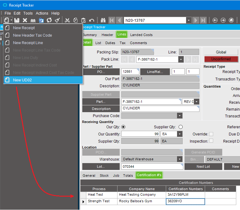

What about a new UD record - from the main menu?

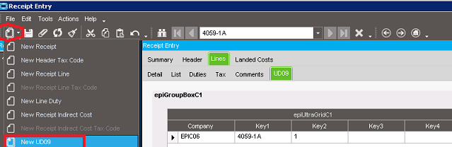

Ref screen shot
And note the keys I used - PackSlip = Key1, PackLine = Key2
— may try those, and then use Keys 3 and 4 for your other fields?
Mr. Ordway,
I am actually able to enter and save data using my initial setup. Specifically using the ‘New UD02’ menu option worked … (I’m new enough to Epicor that I wasn’t used to this yet)

Instead of previous example, I have make adjustments in the wizard generated code.
e.g. something like this
// Comment Out ****************
//this._edvUD09.AddText = “New UD09”;
// Add New Line *****************
this._edvUD09.AddText = “New XXXX”;
and this
	private void baseToolbarsManager_ToolClickForUD09(object sender, Infragistics.Win.UltraWinToolbars.ToolClickEventArgs args)
	// EpiMessageBox.Show(args.Tool.Key);
	switch (args.Tool.Key)
		case "EpiAddNewNew UD09":
			GetNewUD09Record();
			break;
		//NEW Case **************************************
		case "EpiAddNewNew XXXX":
			GetNewUD09Record();
			break;
Off the top of my head I don’t remember having to change anything else.
