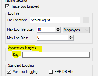

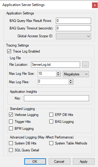

They did implement AppInsights. You can add your own Azure AppInsight Key via Admin Console now I think since 10.2.600

Why not? Isnt it a matter of me creating my own Azure AppInsights account. Adding my Key and enabling telemetry? :slight_smile:
I read it as it’s part of the Azure Monitor service, and that’s only in the cloud. But honestly, I did not dive deep into it, so there might be a way.

Epicor sends it to Azure App Insights and you can change their Key and put in your own key on your own Azure Account and get the same info. I have more info on what it collects here (as of 10.2.100)
For Kinetic it will track URL Changes if I recall. Again in 10.2.600+ you can opt-in to Receive a Copy of the Telemetry data or override Epicor’s Key in Admin Console. Its a start.
