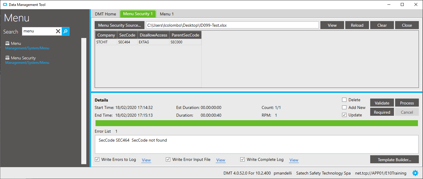

Ok so I created the menus for the Group.
Now can I do a BAQ and form ‘ICE.Menu’, get all the security IDs (2720 in my case)
and do a DMT for all of the IDs I found in the query?
(obvs with the ‘DisallowAccess’ column with my SecurityGroupCode in) ?
Like ‘SEC159’ (Part), ‘SEC160’ (ShipVia) and so on…
EDIT:
I’m trying to do the BPM but I can’t understand why it won’t find the SecCode i throw in…
