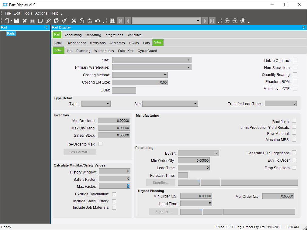

Interesting question. Alas I have nothing snazzy or at hand. Wouldn’t you want to drive some of this information with data from Part/Site/Detail?
It would be a good one for DataDiscovery would it not?
Yes, I plan on doing that. I will be getting a quantity on how many fit in a bin and populating that somewhere, whether I hijack a field like max on hand that is no longer useful with non-quantity bearing, or create/convert a new field and throw it on the attributes tab.

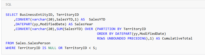

I’m looking at this run a sum based on subsequent rows.
Specifically this part
It looks like you can specify the number of rows that you want to use. Instead of using the number of rows, is it possible to use a difference to determine which rows to include? I want to include x number of days from the PartDtl table, so that whenever a usage pops up, it looks ahead from the date on that row, and includes a cumulative sum within X number of days. Then I’m going to filter rows based on that sum being over a threshold number.
If I were to use this, it’s only going to grab x number or rows, which may be very concentrated or spread out date wise, so not the most useful. I would really rather not have to populate a whole sub query with empty dates just to make this work, but if that’s what I have to do, I guess I just have to do it. I’m just wondering if there is a way to make it work.
