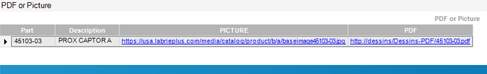

We do this in dashboards by using the following code:
private void MainController_Load(object sender, EventArgs args)
          grid1.DisplayLayout.Bands[0].Columns["Calculated_pdfurl"].Style = Infragistics.Win.UltraWinGrid.ColumnStyle.URL;
		grid1.DisplayLayout.Bands[0].Columns["Calculated_picurl"].Style = Infragistics.Win.UltraWinGrid.ColumnStyle.URL;
This changes the two calculated columns named Calculated_pfdurl and Calculated_picurl in grid1 to hyperlinks like shown:

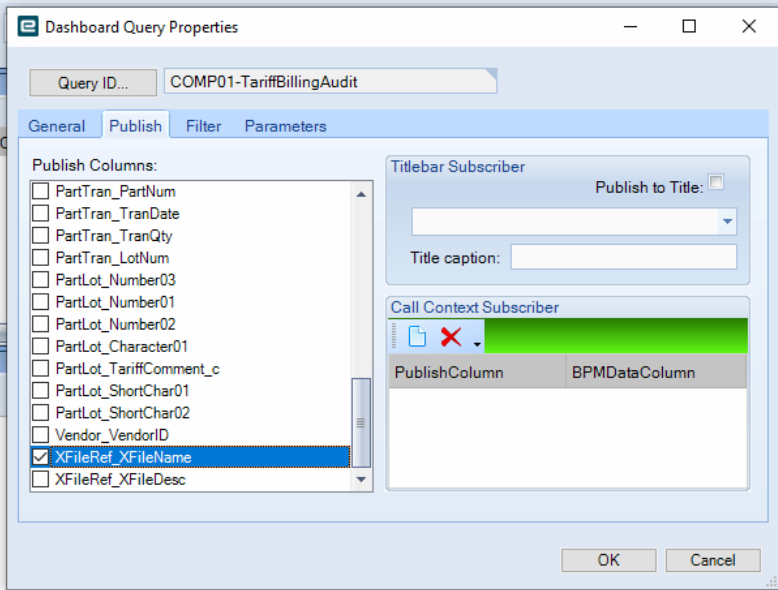

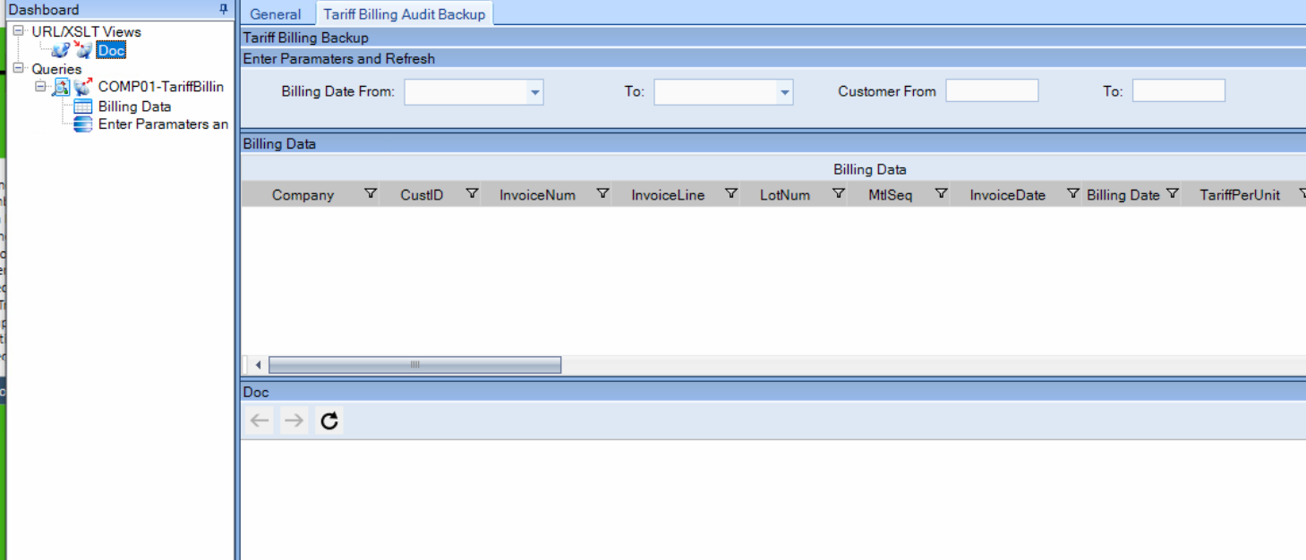

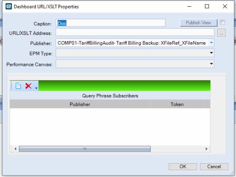

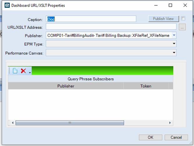

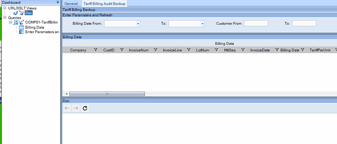

Here is mine. I don’t have anything there.

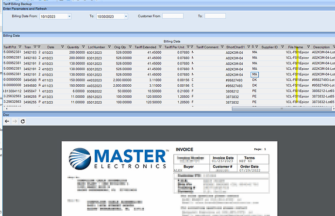

You publish from the query and use a URL View.
As you click on the row the PDF below changes.
