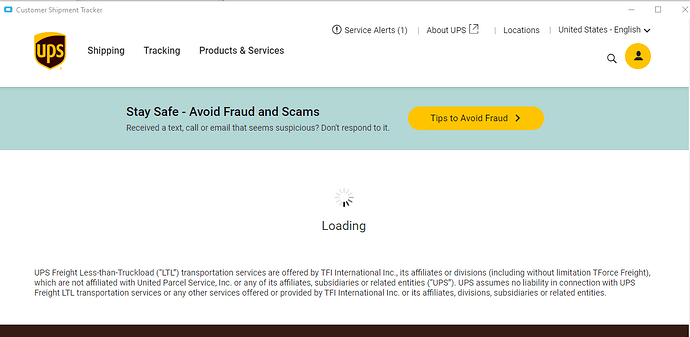

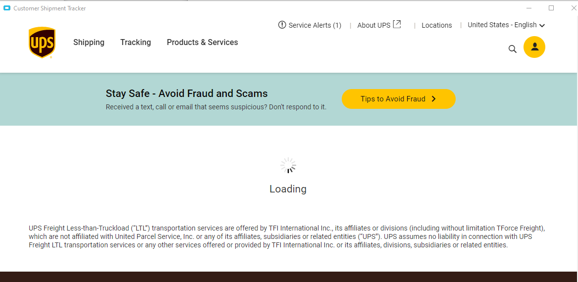

Normally when a valid UPS Tracking Number is entered in Customer Shipment Entry, AND the UPS URL is properly entered in Ship Via Maint, THEN the Details button on Cust Shipment Entry open a browser to the UPS tracking site. But, for the past few days or weeks, we get the UPS webpage just hangs at “Loading” forever.

If I manually substitute a valid tracking number into the string, then paste it into any browser, UPS site delivers the tracking info without problem.

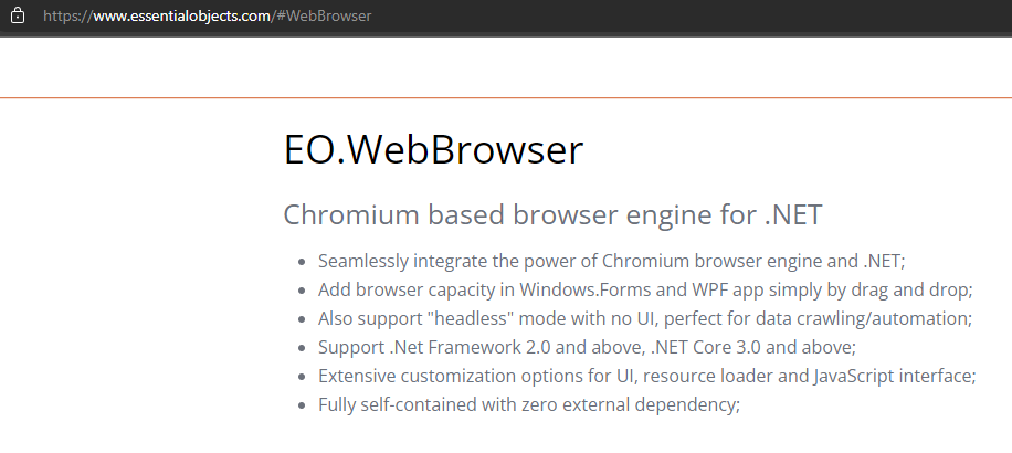

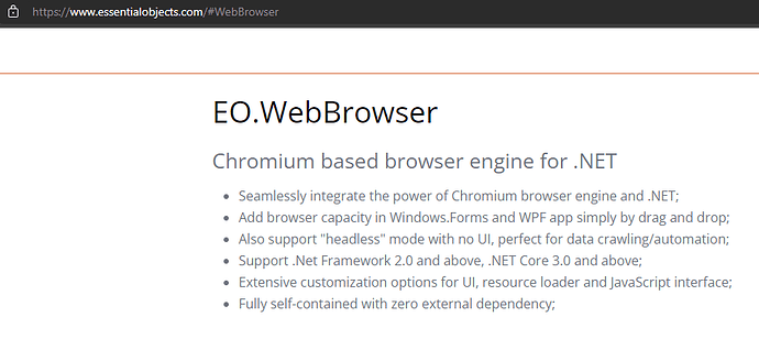

And that will still be the case. The EOBrowser is IE under the hood.
Not sure if that is the problem, but you can open IE and try it.

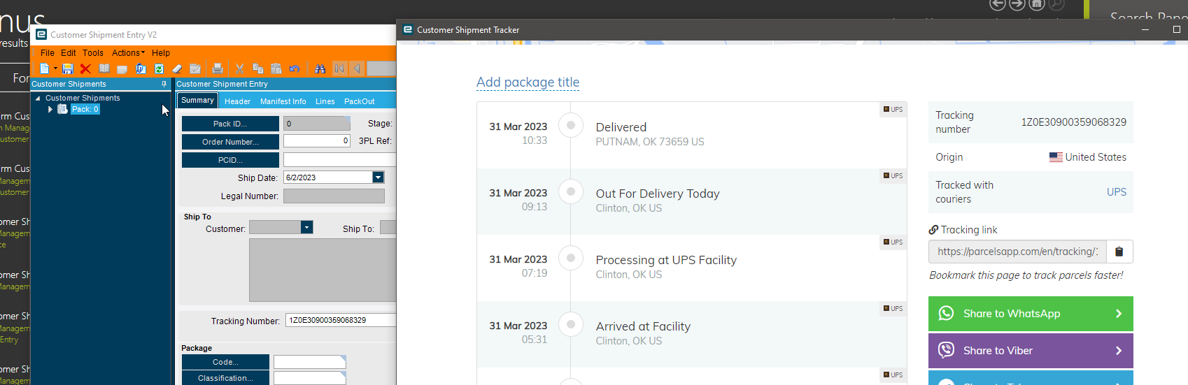

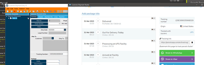

There are a bunch of “sites” “apps” that do universal package tracking. You could change the URL in your system to use that instead.
https://parcelsapp.com/en/tracking/1Z0E30900359068329
By the way this isn’t an Epicor issue, the websites (FedEx , UPS) are purposely eliminating the ability to do embeds and such to force you to pay for API Access.
I confirm that the fix described on the Tracking Details Button Alternative link does work for me in 10.2.700 for UPS.
I can also confirm that the fix described by Jose (using parcelapp.com in Ship Via entries) also allows users to get tracking information and doesn’t require any customization, but the web site puts up lots of adverts.
