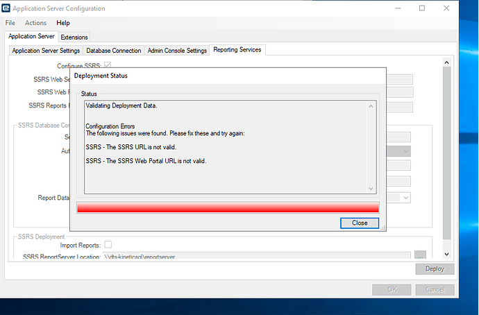

We were able to do the conversion from 10 to 11.2.300.6 after we resynced Epicor10 and made a new backup of the database. Epicor 11 is up and running but the report server will not start. We had everything working and we tested everything over the last 2 months. Yesterday we made a backup of Epicor 10 and ran the conversions. The report server was already setup and working. Today we receive the attached error:

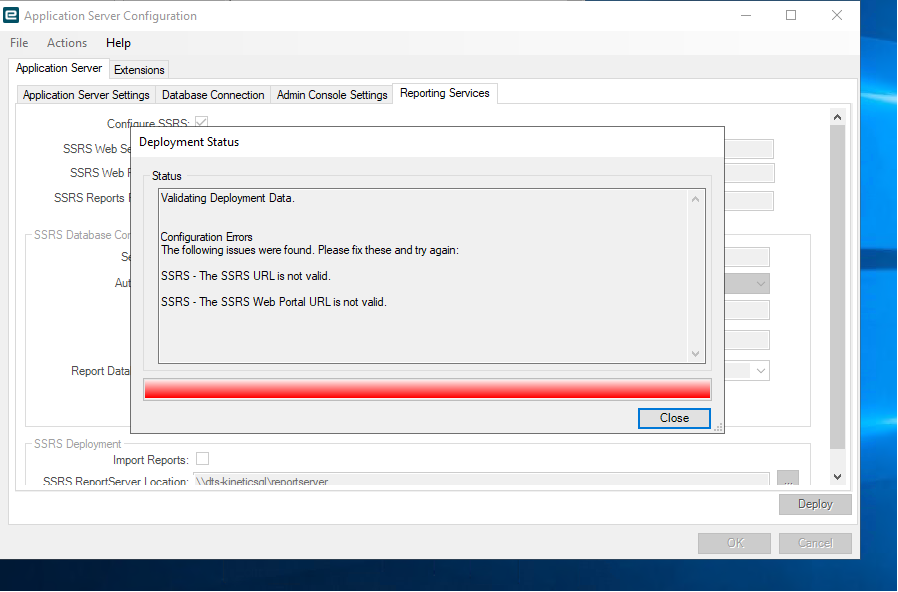

When I try to browse to the Report Server I receive this:
Service Unavailable
HTTP Error 503. The service is unavailable.
Start from the basics. On the SSRS server in the configuration manager is the database right, can you open both web pages?
Does the Epicor Reports database exist? is the name right in the config? No missing slashes.
We started sql and report server with evaluation licenses. Later we upgraded to full licensing. Turns out, report server needed the product code as it was in evaluation mode.
