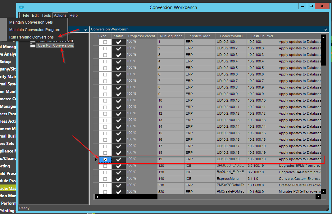

  1. Log into your Epicor client with a security manager user account, and it will put you into the Conversion Workbench.
  2. Click on User Run Conversions.
  3. Check the Exec box for the UD10.2.100.19 conversion, then Actions > Run Pending Conversions
  4. Click back on Auto Run Conversions, then Actions > Run Pending Conversions.
  5. Close out of your client, and log back in.
Does that put you into the main menu afterwards?
I don’t see any of the UD10.2.100 conversions in the list under User Run Conversions?

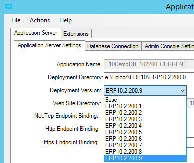

To help those in the future that may run into a similar issue: when a ERP 10.x+ point update is installed on server, all that really happens is that we drop the updated files on the server (and we update the Epicor Administration Console)–the appservers and databases on that server are not automatically updated to that point update unlike earlier releases like with ERP 9.05 where the patch/server pack would update the appservers automatically.
After install a point update on the server, one needs to launch the Epicor Administration Console > Server Management > right-click on the name of the appserver one wishes to update > Application Server Configuration.
Click the Deployment Version dropdown, and select the latest point update installed on the server, then click the Deploy button–that will update the appserver.
