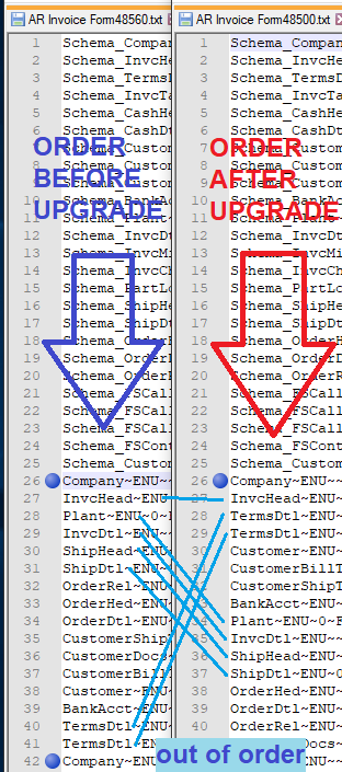

We did a minor upgrade from 10.1.600.5 to 10.1.600.20. Our 856 and 810 outbound maps immediately started failing.
I compared the new (broken) output files against ones that worked before the upgrade. The schema didn’t change (as I would expect in a minor version upgrade), but my data was coming out in a different order than it was the day I created the maps:
I figured I could go back and remap all outbound documents for all trading partners (this could take days), or I could try and get Epicor to spit the data out in the “good” order so the map could interpret them with (hopefully) no changes.
There is an option in Report Style under Actions >> Generate EDI Definition that you should run after you set up your RDD’s and have them working. It generates a CSV reference file that effectively “locks” the schema for you. It will protect you against additions/subtractions (like UD Fields) to any of the tables included in your RDD, but apparently it doesn’t influence the order your data is sequenced.
So I went to the Report Data Definition (create a backup of your RDD with the Solution Workbench just to be safe!) and found the Sequence number the tables are listed in. Shot in the dark, I rearranged the Sequence to match my working Datafile:
I reprinted all of my outbound documents and the map then processed them with no issues. I then had to do the same thing for my other outbound maps’ Report Data Definitions.

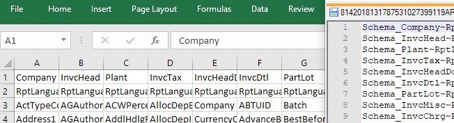

What I discovered is that while the Actions >> Generate EDI Definition doesn’t output the order of your tables correctly, I was able to manually rearrange the CSVs columns in Excel and get the desired result. That saved me the trouble of monkeying with the RDD sequence and is hopefully more durable.
For anyone else facing this issue, the generated CSVs reside at .\EpicorData\Reports\CustomReports\EDI_Definitions
By arranging the CSVs columns horizontally, I was able to affect the vertical arrangement in the output:

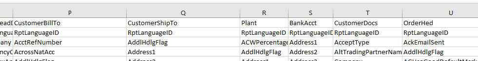

I am having a problem with the order of the tables. I’ve taken the standard RDD for EDIARFrm, duplicated it, and added the OrderHed table (linked to InvcDtl). I used the sequence number in the RDD to make OrderHed my LAST table. Then, I generated the EDI Definitions file, and I modified that by moving OrderHed to the end.
What I’ve got now, is the “Schema” records come out in the correct order. But in the data section below, the OrderHed is NOT at the end. I could care less that the schema’s in the right order.
Here’s a snapshot of part of the EDI Defintiion file, showing the last few columns. Notice OrderHed is at the end.
Here’s a snapshot of the way the output it coming out:
Yes, I know - I can grab OrderHed as a linked table from InvcDtl, but I’m trying to match up with maps that are already in existence. I’ve tried all kinds of things, nothing seems to work. While we could go to workarounds, I’d rather just make the data output match so we don’t have to touch maps.
