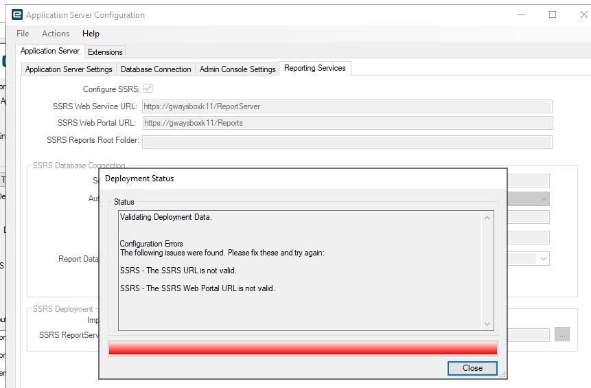

I just upgraded to 2022.2.4 and when I try to deploy the app server I keep getting failures on the SSRS links. This is an OLD sandbox environment that I was using to test the install. Any suggestions where to start or look to see if these links are even correct? I never set this up originally.

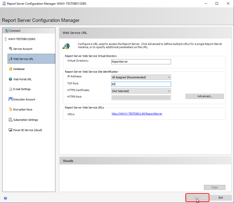

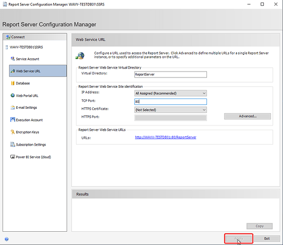

Check the Report Server Configuration Manager on the server. The Windows Service may technically be running, but the Web Service and Web Portal are not actually set up.
Select the Web Service URL and Web Portal URL tabs. If the ‘Apply’ button at the bottom of the window is enabled when they are selected, click it to apply the settings and initialize the Web components.

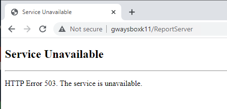

I got it fixed our license had expired for reporting services. It is fixed now.
