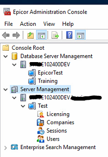

In the Epicor Admin Console you can see the IIS server and the db server.
