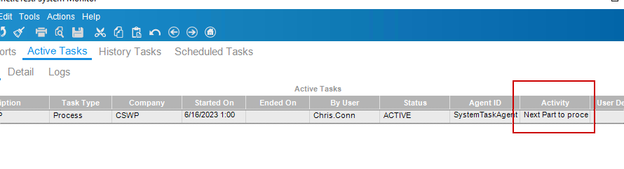

Does anyone know of a way to update the Task Status from a scheduled Function?
Imagine MRP ala “Next part to process”
I have a long running function that I sure would love to just update the status instead of writing logs every where. Thanks in advance and hope you are all doing FABULOUS.

Hi Kevin, when I run an Epicor Function as task (on a schedule), I would like to populate the Activity status (I wrongfully called it TaskStatus which is different) with my task’s status.
