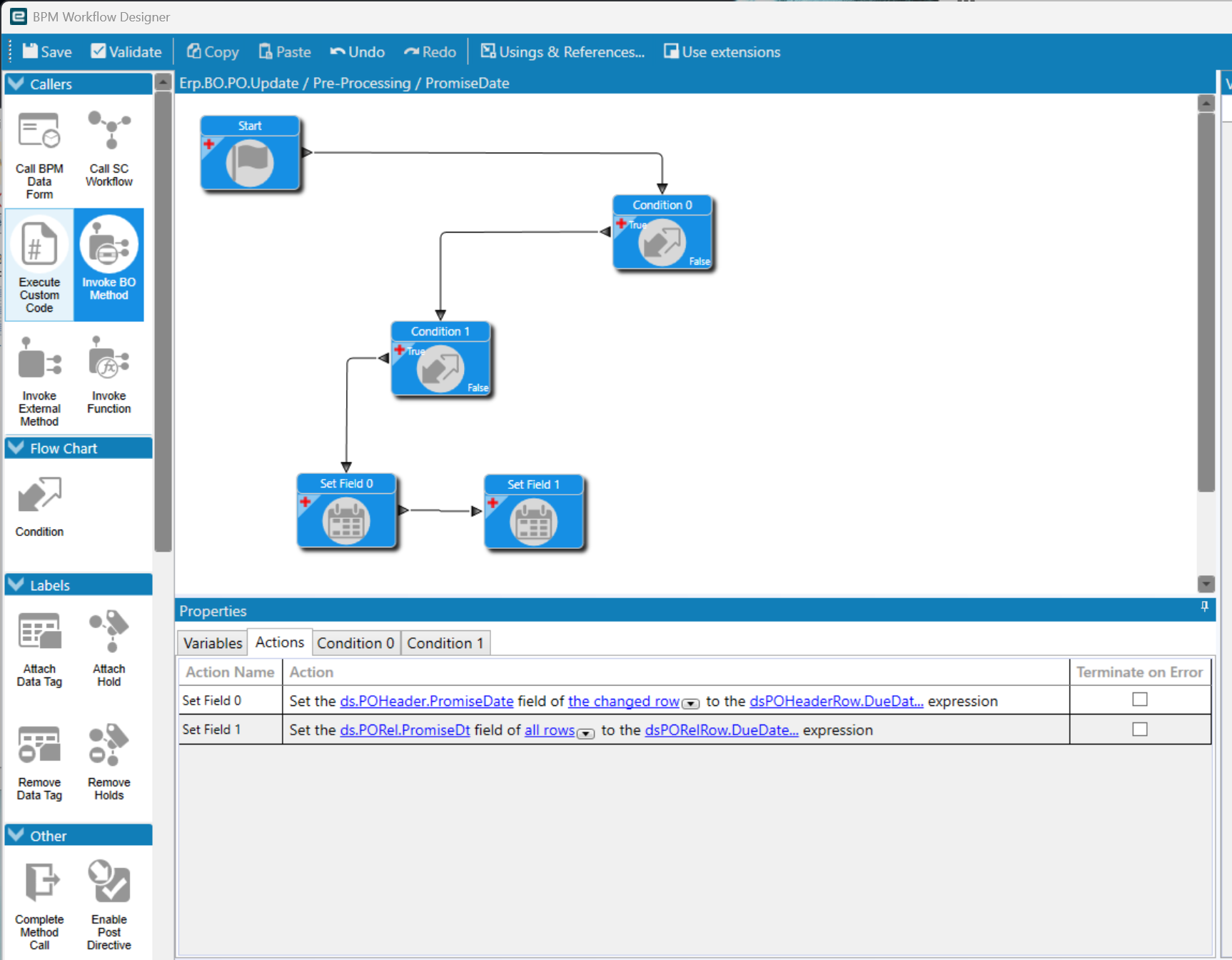

I have a BPM that is checking if my purchase order has been confirmed and if there is no value in the Promise Date field of the POHeader. If both are true, then it updates the header Promise Date to match the header Due Date, as well as all releases’ Promise Dates to match all releases’ Due Dates.

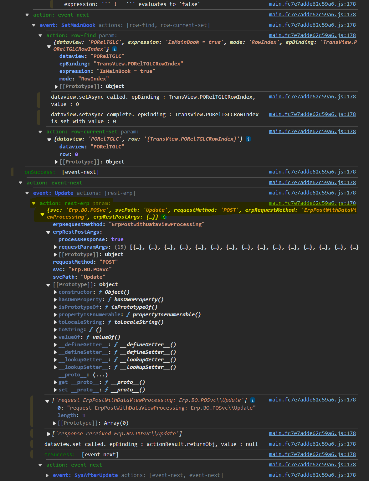

Now, the first part works, and updates the header as such, but I cannot get the PORel.PromiseDate to update. I’ve looked through the console to see what else could get called, but it really just looks like it calls the main PO.Update BO when it saves a release as well as the header. Anybody have some insight here?

While it does use the POUpdate to update PORel, my guess would be that it isn’t updating PORel because you’re not sending in any PORel records to be updated.
Your test is running when you are updating POHeader (confirming it) and is working with the dataset that has been passed in. No PORel has been passed in so it doesn’t do anything with those.
