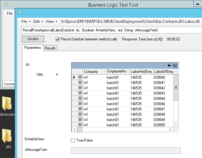

I tried several different ways to do this, but no luck yet. My current trial involves a custom EpiNumericEditor box on the End Activity screen for “Burden Hours” that’s tied to a UD field to temporarily hold the BurdenHrs value for that LaborDtl record. I figured maybe I could mimic the steps I take within Time and Expense Entry to update the Burden Hours. So, I ran a trace on these steps and using the Trace Parser from @josecgomez (love it!), I could see all the objects and methods being called.
The first one I’m stuck on is LaborImpl.RecallFromApproval. When you recall a labor transaction from the UI, it appears to be recalling a single LaborDtl record, not the entire LaborHed record or dataset. So, why would the RecallFromApproval method only have one parameter for the entire LaborDataSet? How would it know which record needs recalled? See my screenshot below from the BL Tester with multiple LaborHed and LaborDtl records coming back from the RecallFromApproval method.

I’m guessing when you do Recall there’s a RowMod on the record you are recalling. So you pass the whole dataset but the one Row that is getting recalled has a RowMod… (I’m guessing here but that’s how some of the other BO’s work)
What does the Diff look like in the tracer utility on that call?
Yup looking at the code I can see that’s what they do.
this.setRowMod(laborDtlView.dataView[laborDtlView.Row].Row);
///other stuff
this.RecallRecords(false, true);
Oh, I see what you mean now. The RowMod of 1 of the records is “U” and the TimeStatus is changed from “A” to “E” for that record. So, if that’s the case, how do I manually set RowMod, TimeStatus, and other fields of the 1 LaborDtl record that I need to recall within a BPM (using “Invoke BO Method”)?
You have to set those values
So do a GetByID
Set the RowMods
Invoke the Method.
