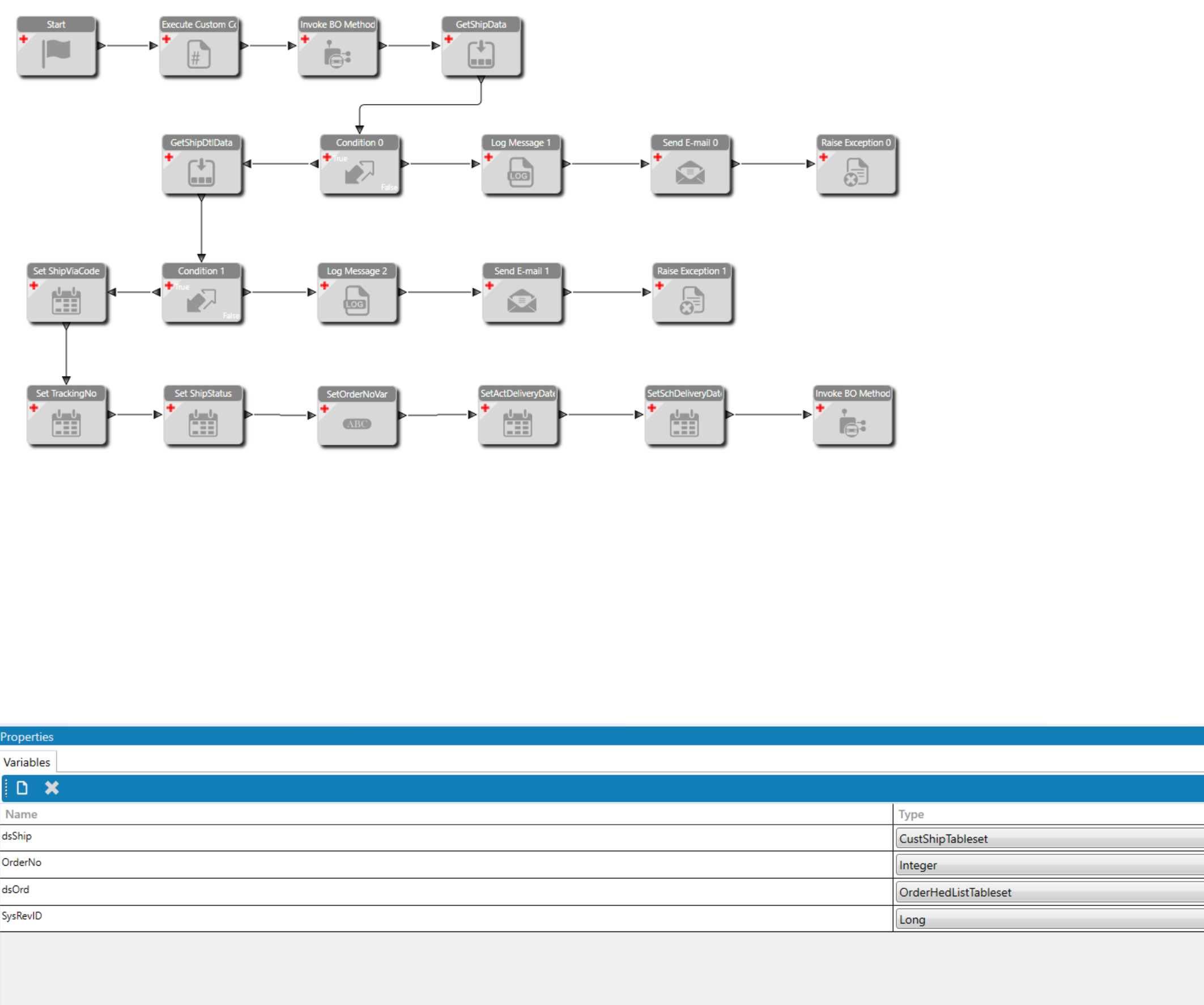

I’m running a (basically my first) function in an API call, where we receive certain parameters through JSON - example below - for a customer shipment and then need to update those fields in the Customer Shipment (and the Order itself, but I’m focusing on the shipment first), and my function is not exactly working the way I expected it to. My layout is below, but the intended logic is as such:
  • Pull in the ShipHead record and any ShipDtl records that match.
  • Update the changed fields within the function for the ShipHead and all ShipDtl rows, including setting the RowMod to “U”
  • Invoke the BO function to Update the records in the table.
  • Great success!
Can anybody shine a light on where I’m going wrong?

Also, attaching the function file, since that screenshot is probably not super helpful.
TEST-TMS.efxb (960.7 KB)

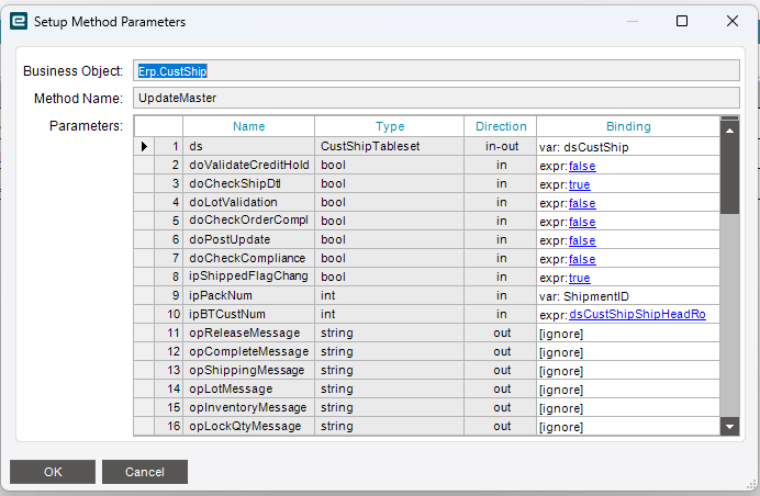

I did try to use the Master function, but I can’t seem to get a tableset that will feed into the function. My standard CustShipTableset isn’t recognized.

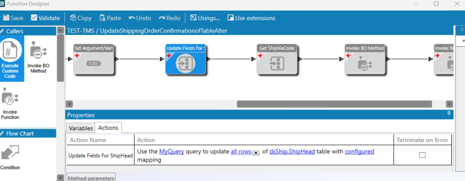

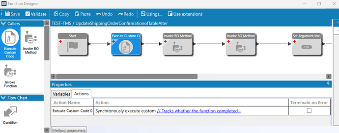

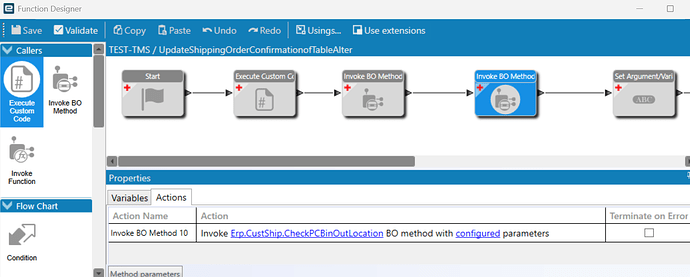

Can you select all the widgets in your function and then screenshot toe rows on the Action tab of the properties? This will help me get a better understanding of what you are doing.
Sure thing!

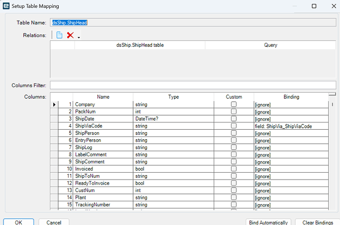

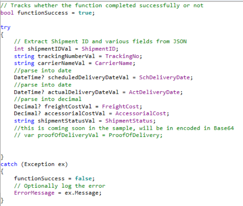

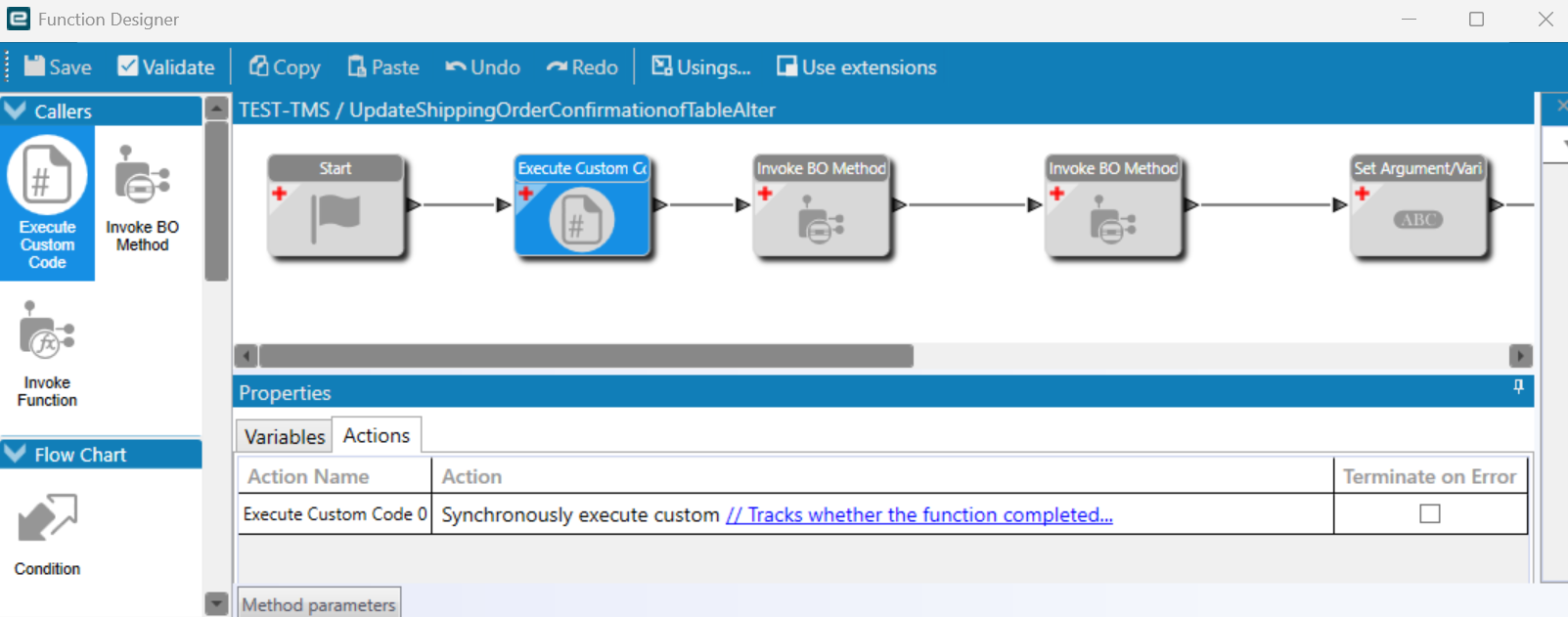

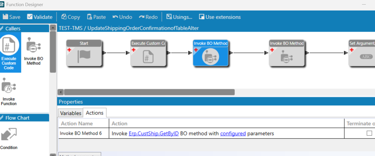

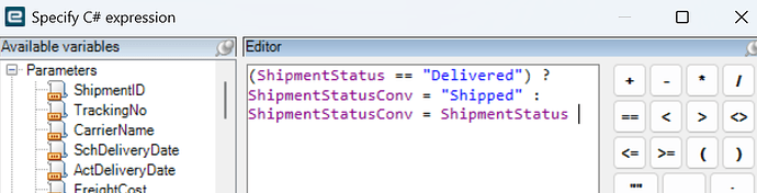

First, I am setting each of the incoming variables to typed variables in code.

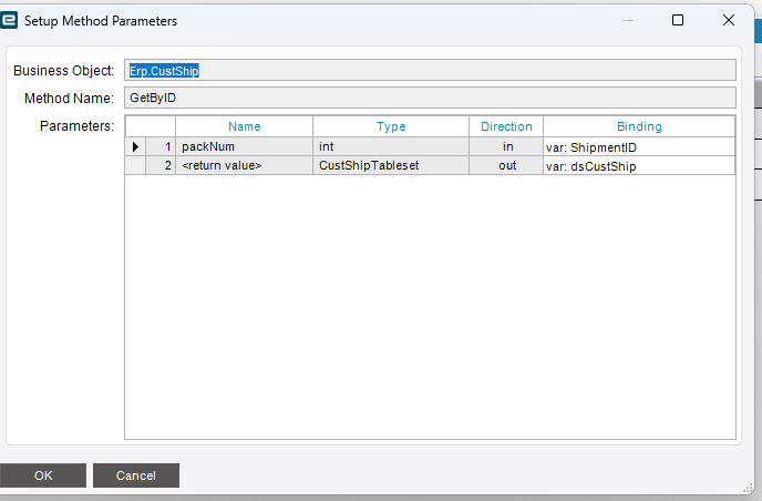

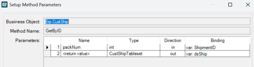

Next, I am invoking the CustShip.GetByID BO to pull in the ShipHead values based on the incoming PackID I received.

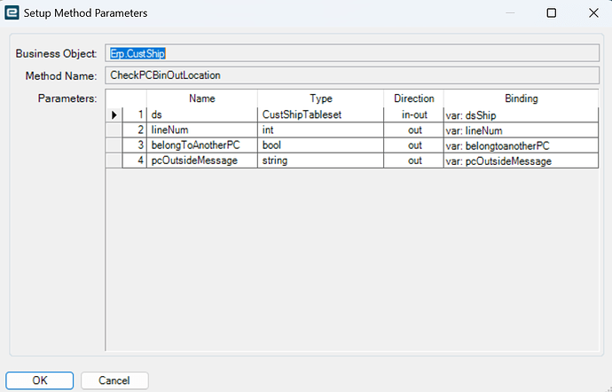

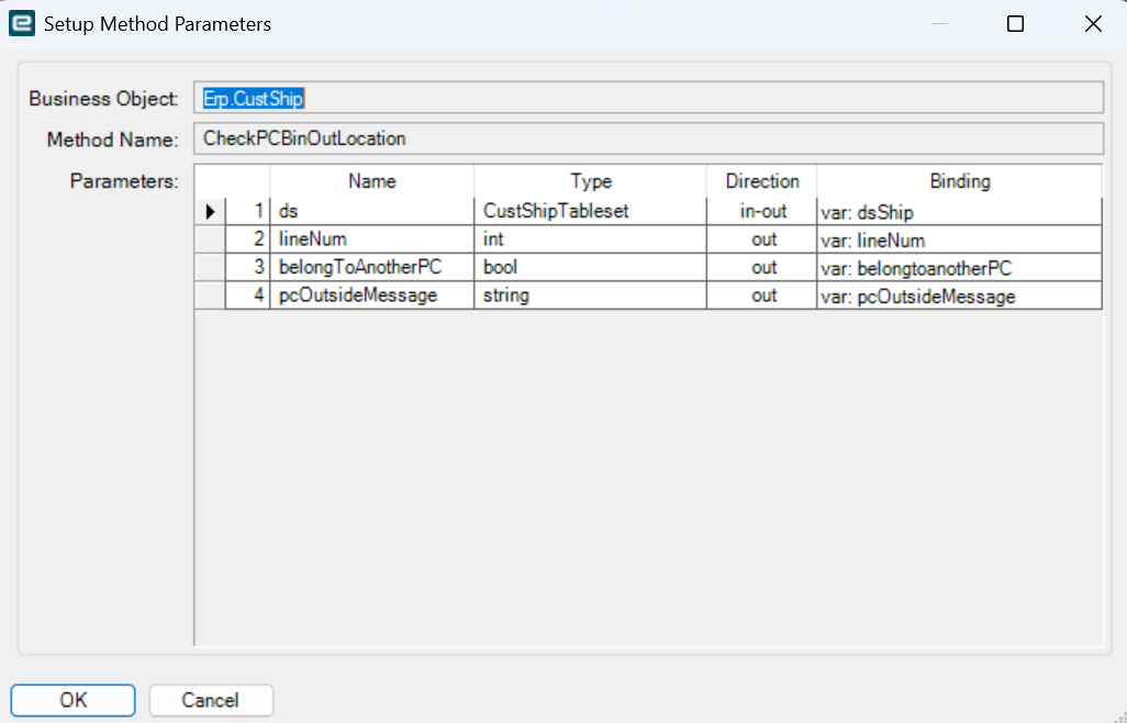

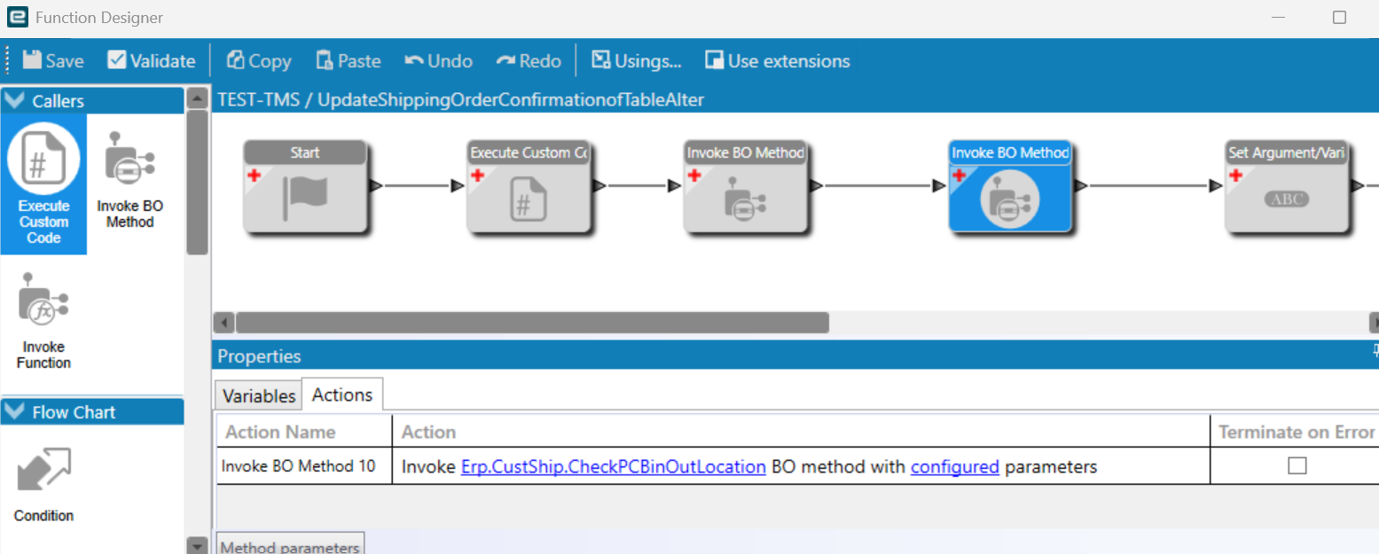

Next, I am invoking the CustShip.CheckPCBinOutLocation, though I don’t think this is making any difference at the moment, but it was in the trace.

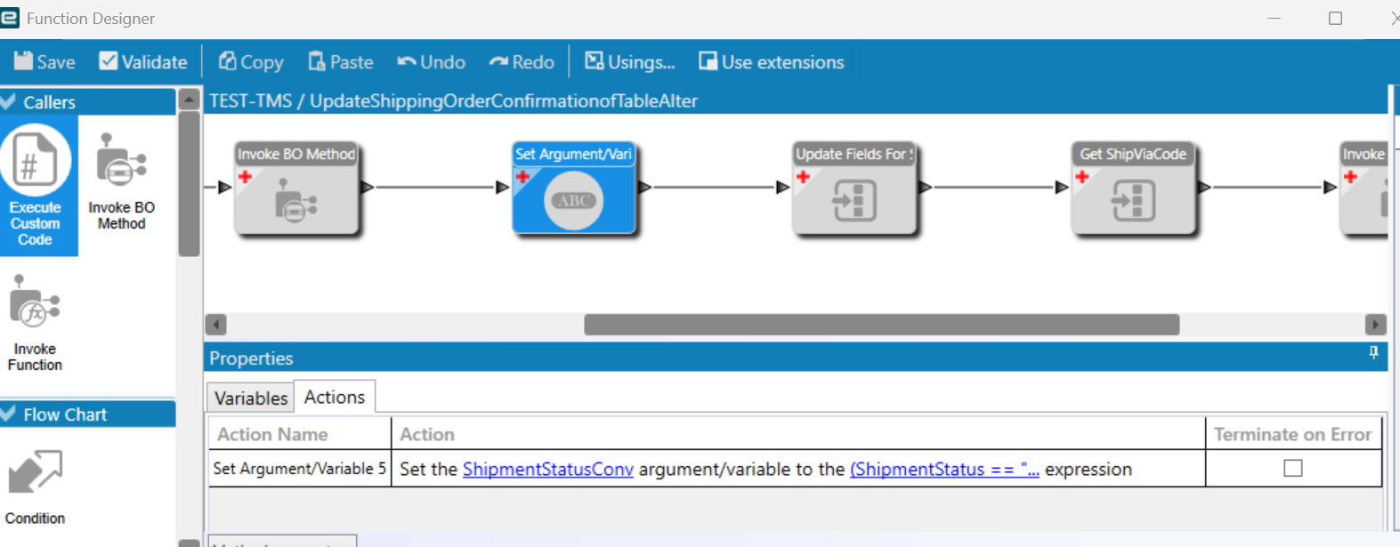

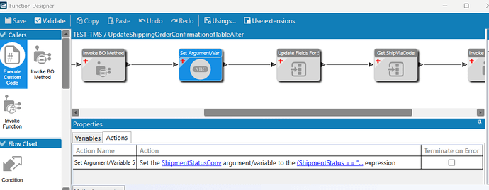

After that, I set a ShipmentStatusConv variable to change the ShipmentStatus I am going to insert, as the user will send a “Delivered” value which Epicor does not accept.

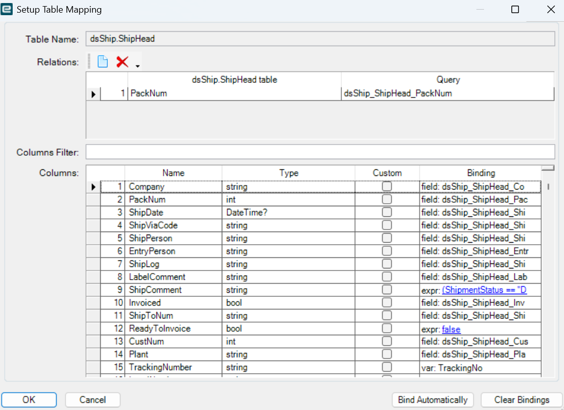

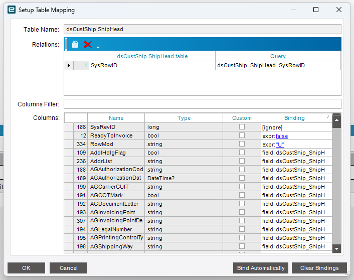

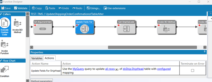

Following that, I update all rows in the tableset with their existing values, based on the query that pulls using the same shipment ID from ShipHead, except those I wish to change (ShipComment (adds “Delivered” text if the incoming status was “Delivered”), ReadyToInvoice (false in case that prevents changes), TrackingNo, ShipStatus, and SlipStatus. SysRowID does get ignored.

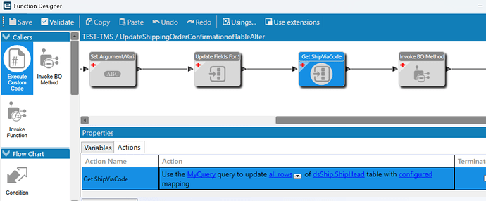

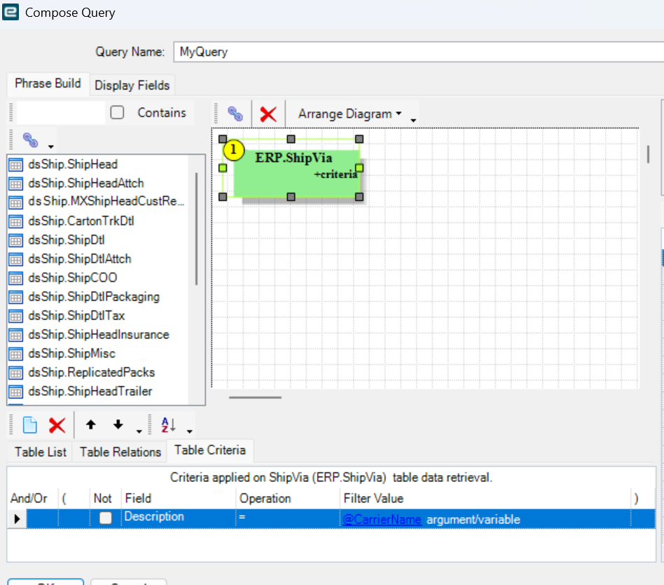

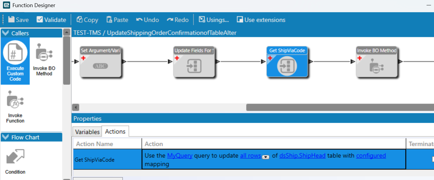

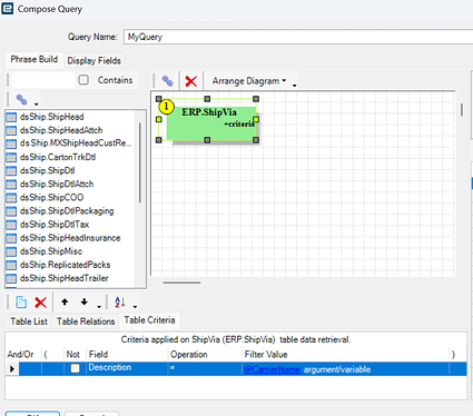

Immediately after, I run one more update, based on the ShipVia table, so that I can update the ShipViaCode based on the description that is sent from the API. I also update the RowMod to “U” in this step.

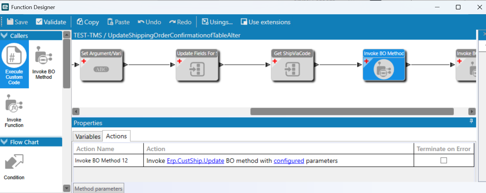

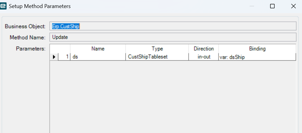

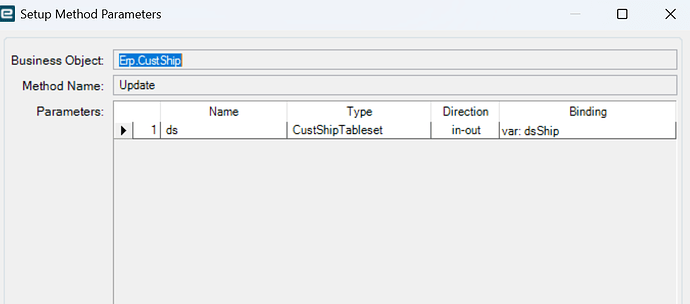

Finally, I invoke the CustShip.Update BO to push the new fields.
I did also add an invocation of CustShip.GetByID at the end, even though this uses no interface, just like the first one, but it returns the error that it can’t find the record due to it deleting the previous on and recreating it.

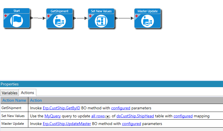

I suggest starting small and building from there. Something like -
GetbyID-

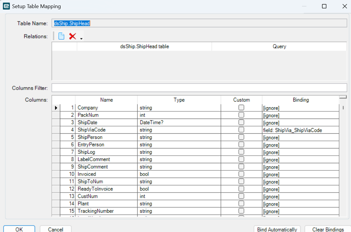

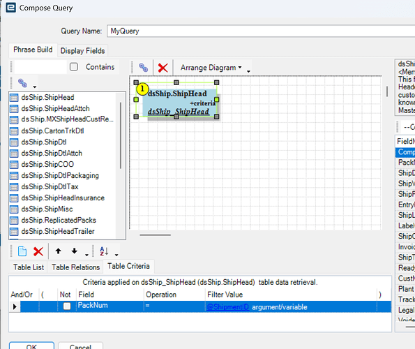

Set New Values - The query for this update is just all fields of dsCustShip ShipHead with no filter.
UpdateMaster - You may want to capture some of the output to variables for later use.
Test with a Pack that is marked shipped and see if this will successfully update the pack to make it not shipped.
Once successful with that, add other new values in the Set New Values step.
It’s possible that you might have to complete the “unship” step before you can update other fields. i.e. your function might need multiple Master Update steps.
