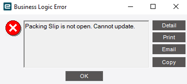

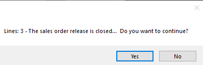

If I click yes, I get this:

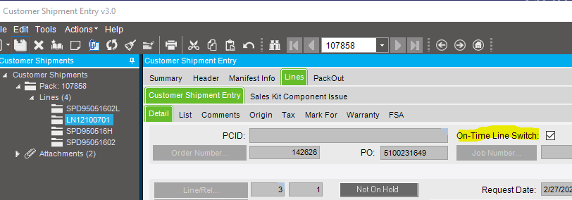

Here’s the control field on the Lines tab in Customer Shipment Entry:
I get the native control references at the beginning of my code, I used the event wizard to add the functions. All is fine for my field on ShipHead, the issue is the field on ShipDtl.
I’m using the EpiDataViews and coding the field updates instead of using EpiBindings so I can use these fields if the pack is closed or not.

If the record is locked, you won’t be able to update it with the user interface (which runs the Update BO server-side).
For the shipping screen, if it isn’t invoiced, you can uncheck Shipped and reopen the line. That unlocks the record and your customization should work. If it is invoiced, you can’t reopen it.

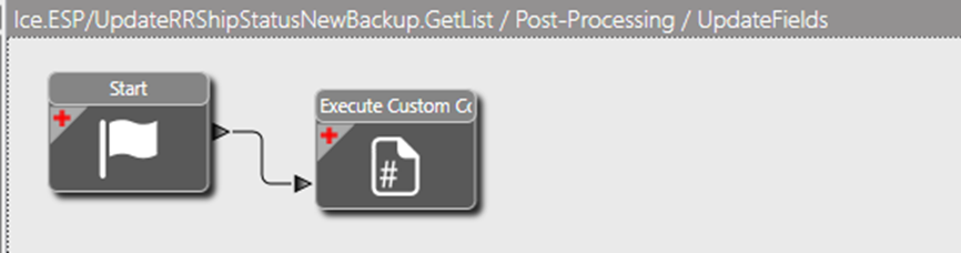

Post-processing on GetList:
Code:
foreach (var ttResultsRow in result.Results)
    var ShipDtl = Db.ShipDtl.Where(row=> row.Company == CompanyID && row.SysRowID == ttResultsRow.ShipDtl_SysRowID).FirstOrDefault();
    if (ShipDtl != null)
        ShipDtl.SetUDField<System.Boolean>("ShipDtl_RRList_c",ttResultsRow.Calculated_tempRRList_c);
        ShipDtl.SetUDField<System.Int32>("ShipDtl_ShipTimeCode_c",ttResultsRow.Calculated_tempShipTimeCode_c);

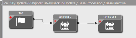

At first I got an error that there was no Update method, so I created a Base Processing method that also sets the two fields:
queryResultDatasetResultsRow.Calculated_tempRRList_c
queryResultDatasetResultsRow.Calculated_tempShipTimeCode_c

Changed the Base method for Update to /* */

Added a message box to the Post-Processing directive on GetList to see if it is firing. It is.
