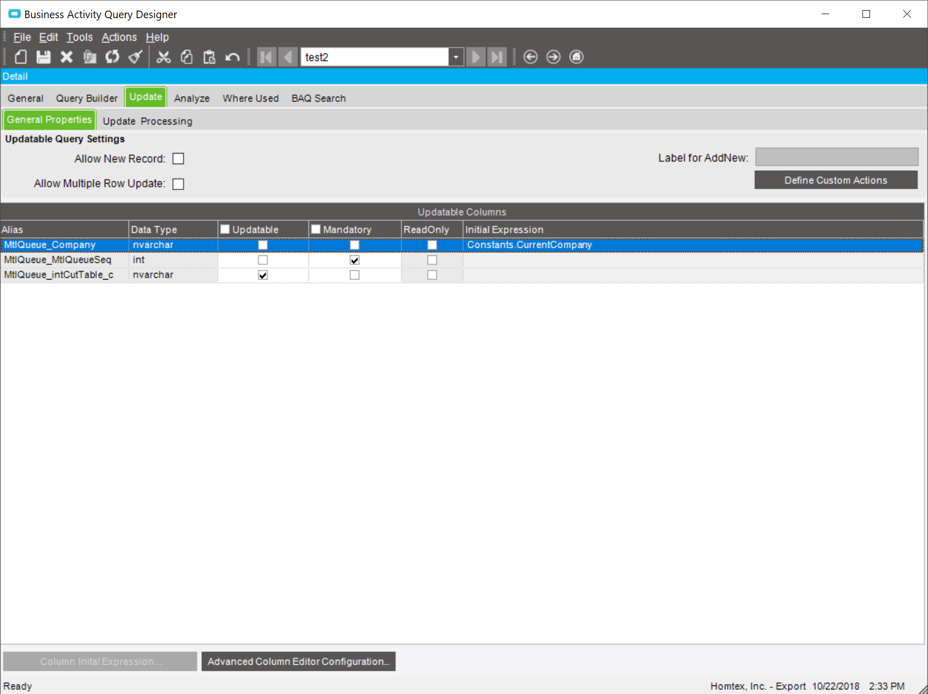

Can you post screenshots of your update tabs to show the configurations you’ve made in the UBAQ?
Here’s the UBAQ update tabs. The MtlQueue_intCutTable_c is the custom field that I’m trying to update.

I have seen this with the GetByID method and even when using BL Tester. I ended using GetRows but was able to in that situation. The error that GetRows gives when the whereClause is empty is the exact error you are getting. Guessing a bug.
