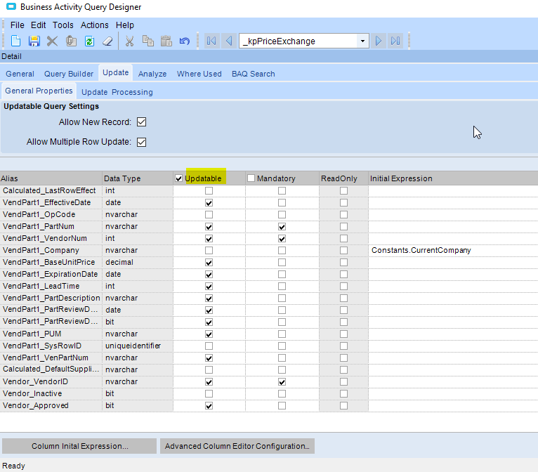

Are you looking for a general how-to create a UBAQ?
Here are some screenshots to get you started from something I made.
Key Fields must be displayed in your query or it will error. You can then hide them in a dashboard if you like.

A couple of notes:
When you add the query to a dashboard you’ll want to go into the grid properties and mark the grid as updatable and also click the Prompt field on each updatable field.
Also – when you mention “Methods” are you talking about Methods of Manufacturing? If so, you won’t be able to do that through an updatable BAQ. The checkin/checkout processes aren’t available there.
