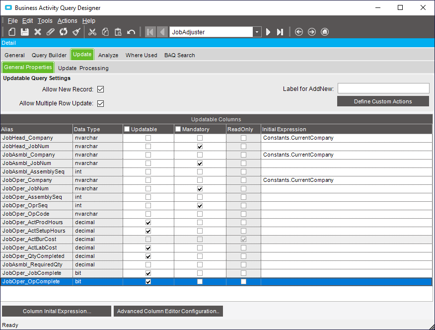

I’ve created an updatable BAQ for job costs and completed quantities. I can change most of the fields I’m using except the JobOper_ActBurCost field. It’s greyed out and I can’t change it. See pic below.
JobOper.ActBurCost
Total Burden cost to date. This is update via the LaborDtl\Write.p trigger procedure. It includes ALL burden costs (Setup, Production and Rework)
This quote is from the table/field descriptions. Perhaps you can use the LaborDtl as it suggests?
