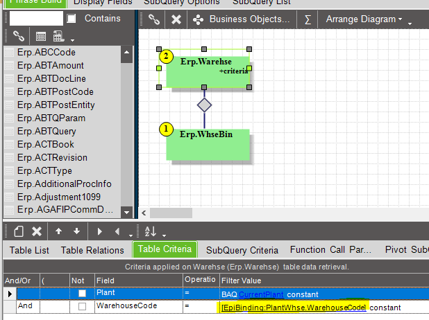

I am creating an updatable BAQ so users can edit the primary bin of a part. Instead of allowing the user to enter it manually, I want him to select form a list.
So I set up a Column Editor config, where I used a drop down type, using a BAQ showing all the bins of all the warehouses.
Question: How do I filter the baq dropdown list in order to only show the bins from the selected row warehouse?

I have found the following:
Create in the BAQ associated with the dropdown a condition with a Constant. And as a Constant value write
[EpiBinding:TableName.FieldName]
where the BAQ result would then be filtered with the specified value.

So I tried the following, with no success…
Dropping down the list…no list was showing…So I must not use it properly…

I realize I am only 4 years late here, but your post got me 95% of the way there and I was able to figure out the last 5%. So updating here for others that may come searching.
Your EpiBinding was incredibly close. It needs to reference the EpiBinding for the table, followed by the field name. So in your case you had [EpiBinding:PlantWhse.WarehouseCode] - you needed something more like this:
[EpiBinding:V__1view.PlantWhse_WarehouseCode]
Note the PlantWhse_WarehouseCode is an underscore, not a period. You can compare this in the Dashboard editor to see what Epicor calls it there.
I was able to do this for Projects and Project Phases to limit the phases to match the previously selected Project upstream.
