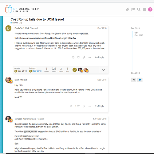

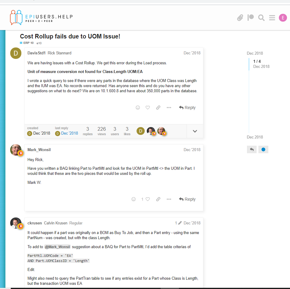

Try this thread. It helped me with a similar issue.
I already did that code below
    select * from PartMtl a
left join part b
on a.Company = b.Company
and a.PartNum  = b.PartNum
where a.UOMCode = 'ft' and ClassID ='count'
