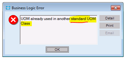

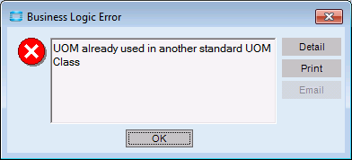

But now I can’t seem to add conversions to the new Class. I get
I thought maybe I had it backwards and needed to add the UOMs of the Old Class to the New Class, but that gives the same result.

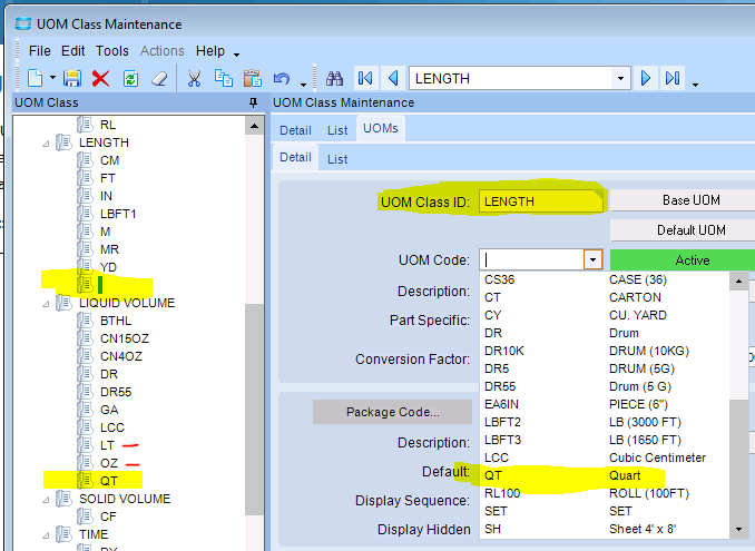

The screen shot below shows adding a new UOM Conversion to Class LENGTH.
Notice that UOM “QT” is available, even though it is already used in class LIQUID VOLUME, while LT and OZ are not.
I think I found the problem. (It was spelled out right in the error message)
LENGTH and COUNT are “Standard” Class types.
The time I was successful must have been to/from a class type of “Other”
(I made separate classes for Liquid volume and Solid Volume, and one of them must have been used)
