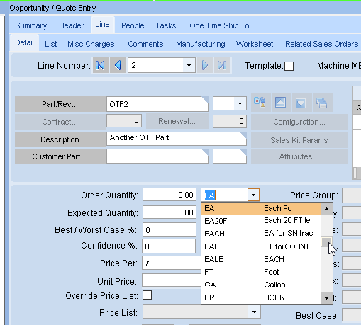

When you add an OTF part on a quote line, are any of the the available UOM’s from the MixedUOM Class shown in the list?
Yes, correct. EA is in UOMClass Count, and Count is the system default in our setup too. But EA is also in the MixedUOM class. On the Quote Entry screen, yes we DO see all UOMs available as options in the drop-down, but since EA is in both Count and MixedUOM, we need to manually specify the class when quoting On The Fly parts else it assumes it is Count – but there is no way to assign UOM Class in quoting. It picks Count behind the scenes and doesn’t give me an option.

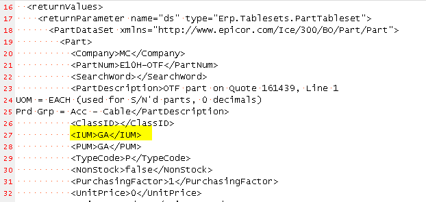

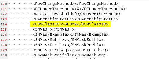

I tried doing a trace to see if there was a BO on the new part record creation, that you could intercept and change the UOM at the time of new part being created. What I found was that Part.ChangePartNum() is called during part creation in part maintenance. The return parameters show the IUM and UOMClass are being set here:
and

Just did a test using the Part.ChangePartNum() methods.

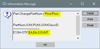

  1. A quote exists for OTF Part E10H-OTF, with UOM EACH - (which is a member of Class COUNT-SN (which is a Class Type of Other), and Class COUNT

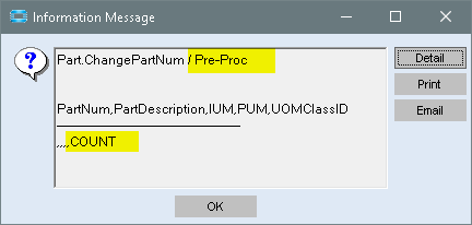

  2. After entering the OTF P/N in Patrt Maintenance, and clicking OK to make a new part, I first see:
Then after clearing that message, the Post-Proc message shows:
The part entry created is with COUNT.EA
BUT…

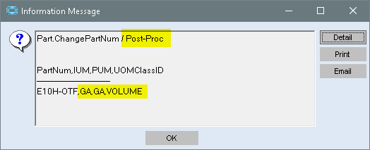

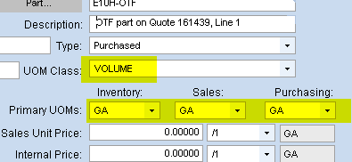

When the quote line has the UOM GA (a member of Class VOLUME, a system Type of “Volume”)
And the part created has a UOM of VOLUME.GA

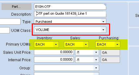

The part created looks like:
That’s almost right - except that the UOM Class is wrong. It’s showing “Volume” - which is the only
UOMClass with UOM GA (that’s what was on the Quote, as shown in the Post-Proc message above)
But if I click on the dropdown arrow for the UOM class, it instantly changes to “Count for Serial Number”. Or if I make the new part and save it while “Volume” is displayed, it changes to “Count for Serial Number”. So it only looks like it wasn’t set right - must be a UI thing.
