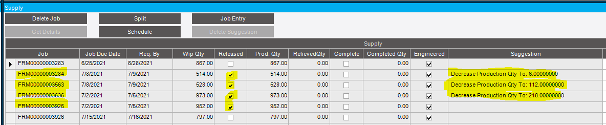

Recently firm jobs created by MRP are showing up as already release, messing with their schedule. Does anyone know how to prevent MRP from auto-releasing jobs or the process which is causing this? I’m also noticing that these are mainly ones with suggestions.

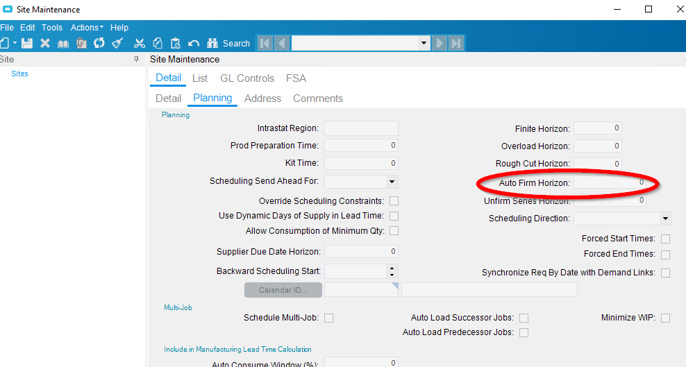

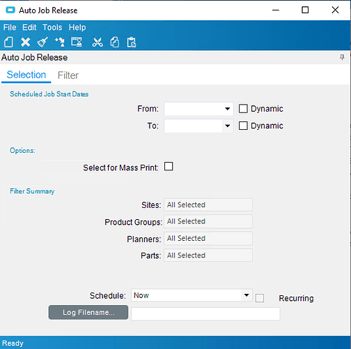

Make sure no one is running nor scheduled the Job Auto Firm nor Job Auto Release Processes.
You should be able to view anything scheduled like this in your System Monitor on the Scheduled Tasks tab, just be sure to enable the ‘Display All Tasks’ option in the Actions menu.
Natively Epicor should not be auto Firming nor Auto Releasing Jobs unless those processes are ran or if there is a BPM setup to do it. If you have an Audit/Change Log BPM (Data Directive) setup on the Job Firm or Job Release fields you should be able to see which user is Firming or Releasing the Jobs.

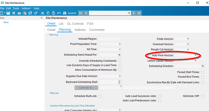

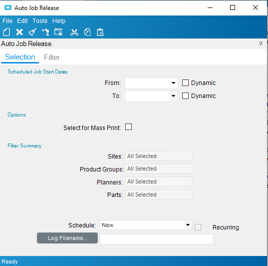

Hi - we are experiencing a similar problem. MRP has been releasing and unreleasing jobs without rhyme or reason. MRP is not firming jobs, but it is releasing jobs… we do not use Auto Firm or Auto Release.
