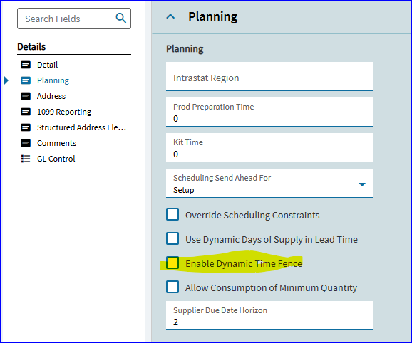

Site Maintenance > Planning
Below is the link to the Epicor Learning Center video for this feature:
2024.2 Feature Spotlight - Dynamic Time Fence
Ah, thank you!
The checkbox was only visible in the Kinetic UI version of Site Maintenance. (I should have suspected that.)

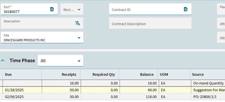

We’ve upgrade to 2024.2.7. This feature doesn’t seem to work in all cases.
Example PN 30180077
PO 25806 is locked with a due date of 2/6, but PO suggestion is still requesting a new PO on 1/28. Min on hand = 20 so the balance is below that. Is that why?
wondering… are you below safety stock? if so, it might break the rule. Otherwise, you should submit this to support.
Yes, I was below safety. It’s been working nicely since then.
