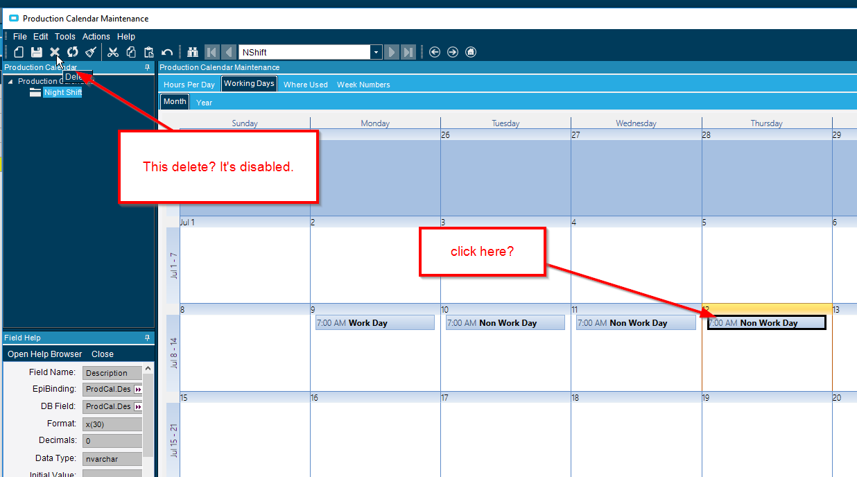

So, Dumb question. I just started messing with the calendar in pilot in preparation for making a BAQ that will need one, and I cannot figure out how to remove the non-work day toggle. I’m sure it’s something simple.

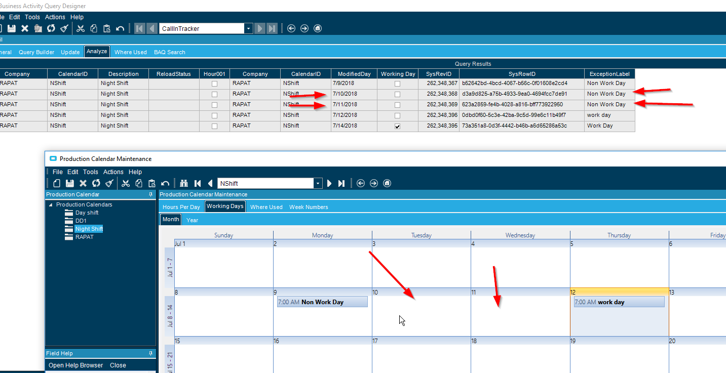

Verify in your ProdCalDay table if the date under this calendar id is still present…
Pîerre
It removes it from the calendar view, however if I check the ProdDay table it is still there, (with “non work day” in the exception label.)

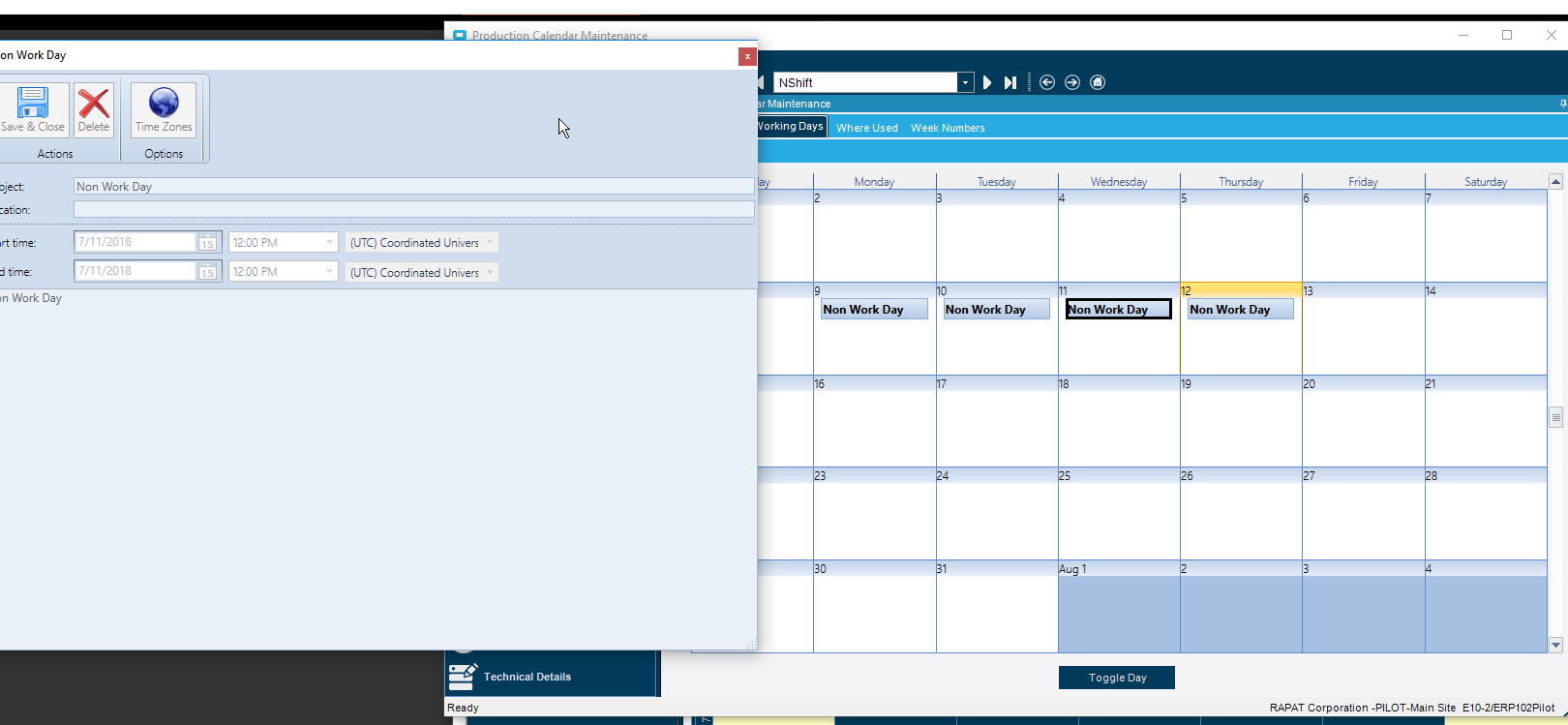

I’m confused why you can double click on the non work day you entered and see that there is a delete button. But you can’t use it, even when signed in as manager.
Me too! So maybe it wasn’t such a dumb question. I checked in 10.1.600 and 10.2.200. Same thing.
And it looks like there is no way to make the working day check box checked either. Even if you type in “Work Day”

I see that with the pop screen too. However, if I single click and press the Del key, it does ask permission to delete and it will with an affirmative response.
