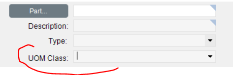

Can you show me these fields for the sales order part? And also the UOM details for that class.
This from the receiving company.
