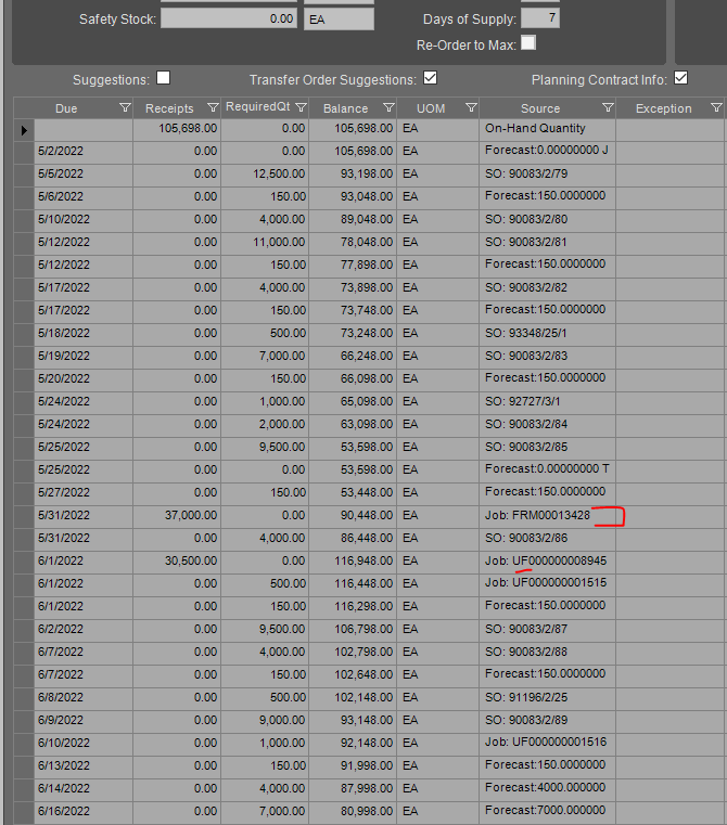

Craig, we do not have “allow historical dates” check marked while running MRP. The new suggestions are in the future. Current firm job in the future. W hat we are trying to do is build some stock but the system still thinks I need a job every 5 days (DOS set at 5).
Hi Tim, my firmed job is not locked. We are trying build stock so I firmed up a larger job than normal. The system still adds an unfirmed job right after my firmed job.

Craig, here is a screenshot of what I am talking about. I have a firmed job (FRM00013428) but the system places an unfirmed job nearby. I did change the DOS to 7 and ran MRP but it still looks the same.

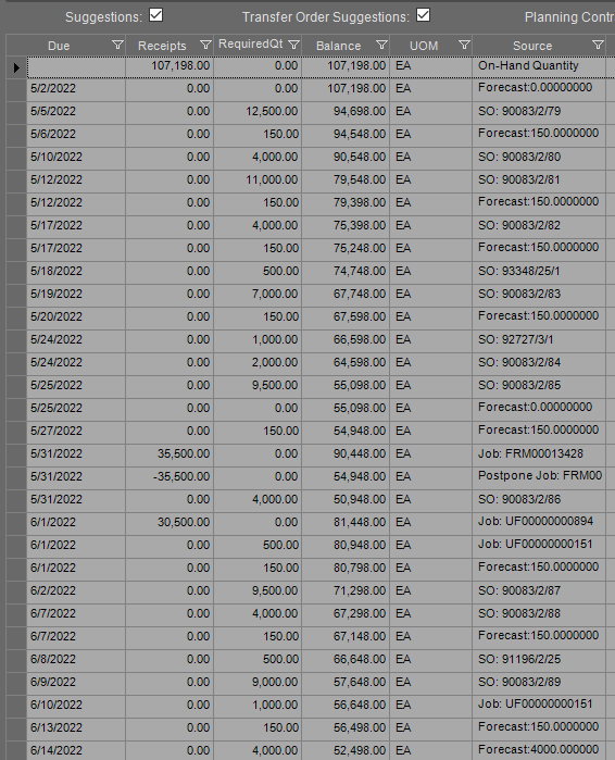

what does it look like with Suggestions on?
With suggestions on it asks to postpone (delete) the 37,000 pc firmed job (which is what it should do). My issue is the unfirmed job.

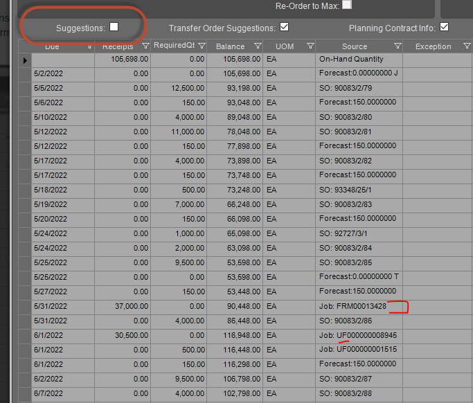

can you click the suggestions box and send the time phase screen shot please.
Another observation, your forecast amounts are not decrementing. What are your forecast parameters, days before and after ? Odd a forecast on 5/25 for 0 with a T at the end ??? Do you have a cutoff date on MRP ??

FCST parameters are zero days before and 5 days after. The forecast you see with T at the end, the T is the first letter in our customers name. I cut it off. No cut off date in MRP.
Thank You
Mmmmm The very end of the time Phase = 0 bal ?
Is there a Min On hand value set? you should be able to see that at the top of Time phase window.
No, it has me +19,198
No min value on hand set.
