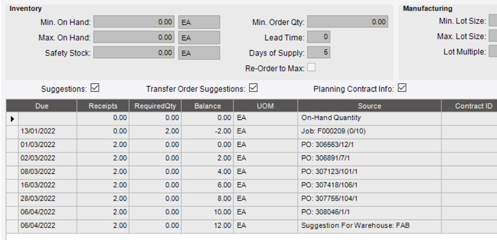

Also from my own environment. There is now way we should see a PO suggestion for this part. I’m assuming MRP could not modify the open POs as they were locked at the time and suggested a new one as it could manage that.
