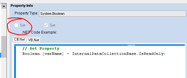

Just looking at the Object Explorer for epiDataView -> … Columns- > IsReadOnly, and I see:
Does that mean this is not able to be set? You’d think it is, as the wizard makes code that works.
