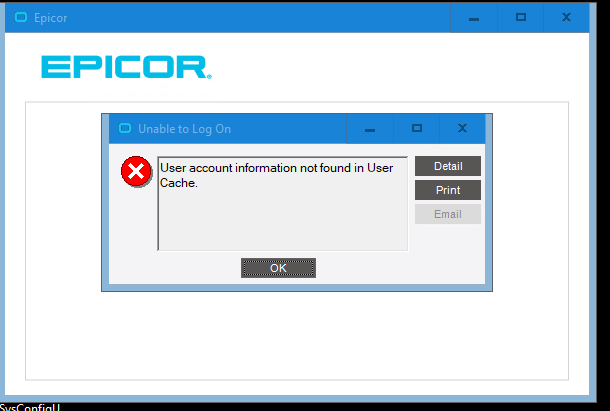

We are migrating to SSO and getting this error frequently (but sometimes not) when attempting to login. We have validated folder permissions and both a custom and non custom alternate client cache location. Anyone have any ideas? Thanks!

I’m trying to upload my 1 MB gif to show what is happening but the site is telling me its too big.

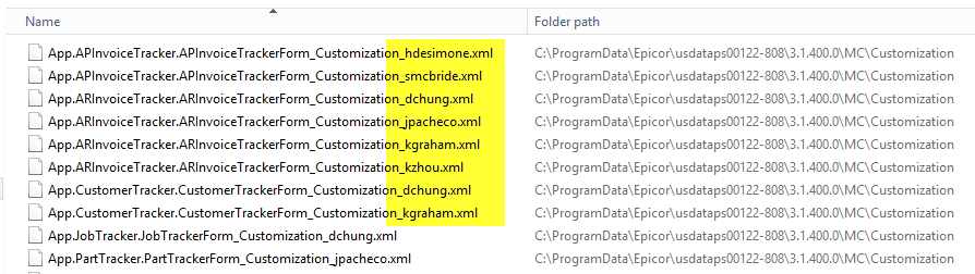

Be careful with your theory about using your domain id as the epicor id being a solution. Many temprorary files are created using the userId as a suffix to the file name (to keep them straight between users…
So having a userid without the number and dot prefix, isn’t really trying to make the same files.
