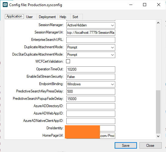

Yes, all good. Nothing about the OS upgrade would have modified any Epicor client .sysconfig files. I checked and it is all still correct, and both Classic and Active view use the same .sysconfig file.

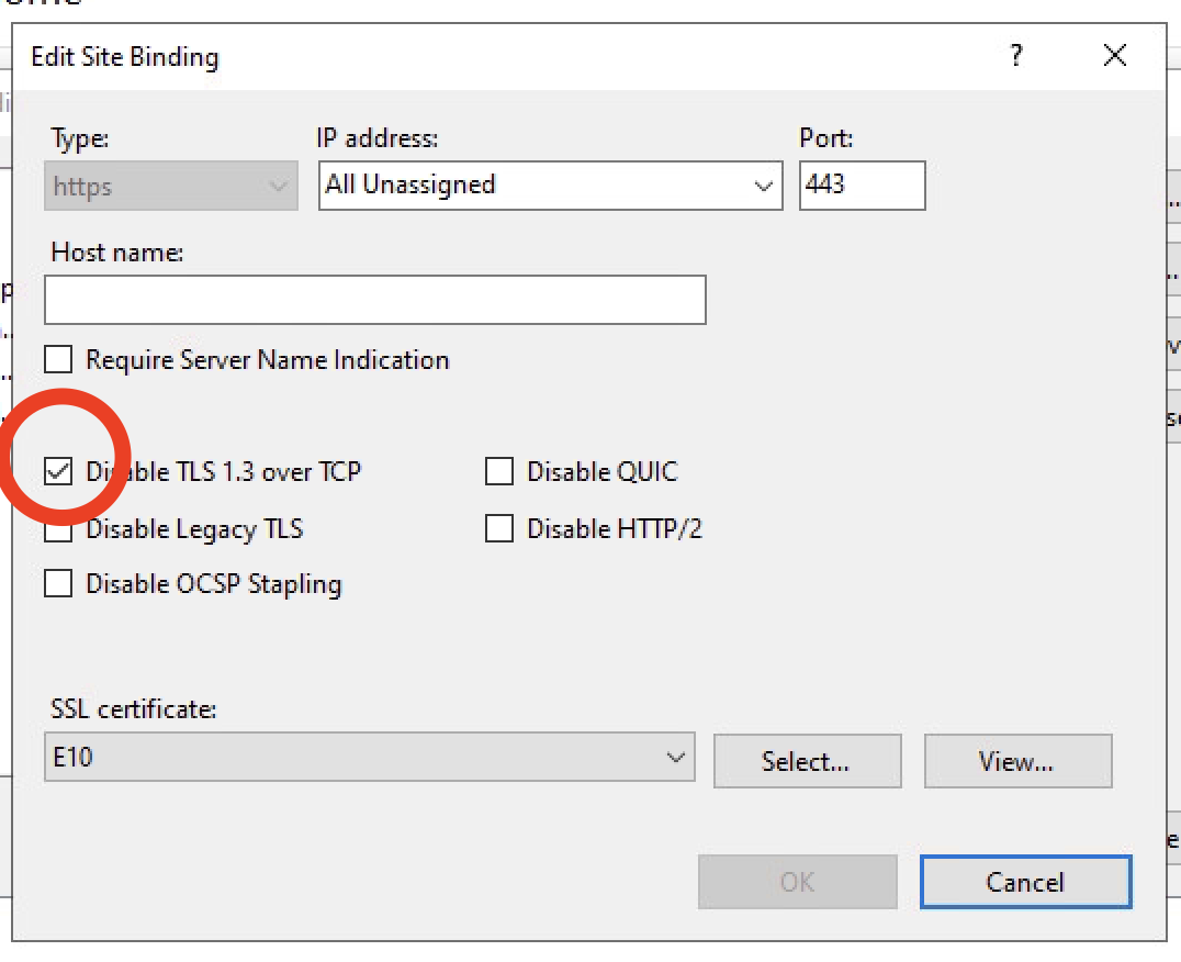

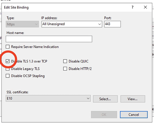

So it turns out that the fix is super simple. I have no idea why it is affecting only one AppServer and the other is ok, that part really makes zero sense to me, but this is what fixes it:

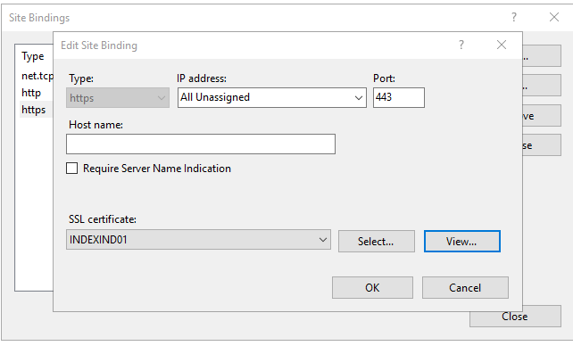

  1. Go into IIS and expand the tree until you get to Default Website
  2. Click on Bindings and go to your 443 binding
  3. Check the box for Disable TLS 1.3 over TCP
  4. Restart IIS
