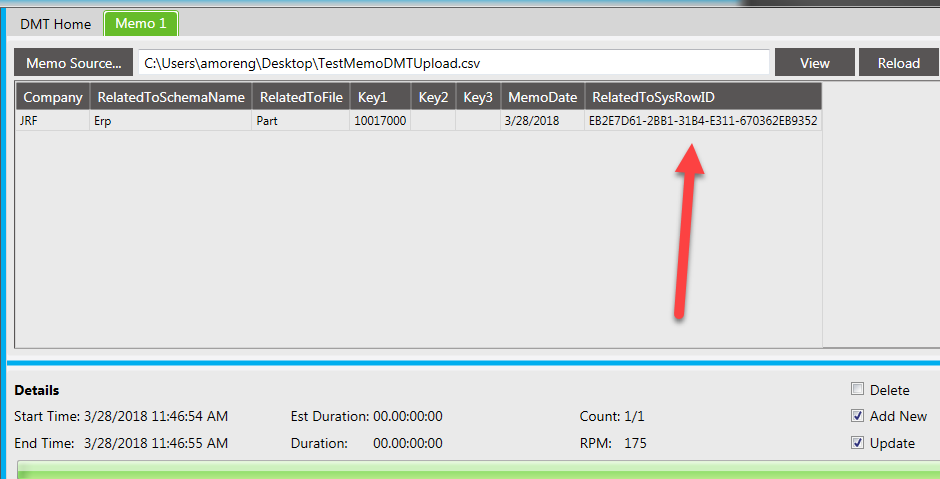

I always get an error when I try to load a new memo through the DMT - error message is: 2018-03-28T09:59:51 Part 05001 Unrecognized Guid format.
Right now I have to manually enter all memos, which can be a pain when I have a large amount to do. This is the template I am using. I have all required fields. I cant figure it out…
Have you tried having DMT make its minimal template, and trying to upload using just that first, then adding your fields one by one until the DMT load no longer works?
Sometimes DMT lies about its minimal list of fields, but it’s easy to find out because it will error-out saying such-and-such field does not exist when you try and load it.
Sometimes DMT gives you an error message that hints at the real issue, rather than nailing what the real issue is.
I looked at the DMT template builder again. I think it has to do with
RelatedToSysRowID Guid RelatedToSysRowID
With other loads you can just leave fields like this blank and it auto fills in. Same with Date/time, user, etc. I guess if this is required data then I defiantly cant do a load. I just think it’s weird because everywhere else you can leave it blank.

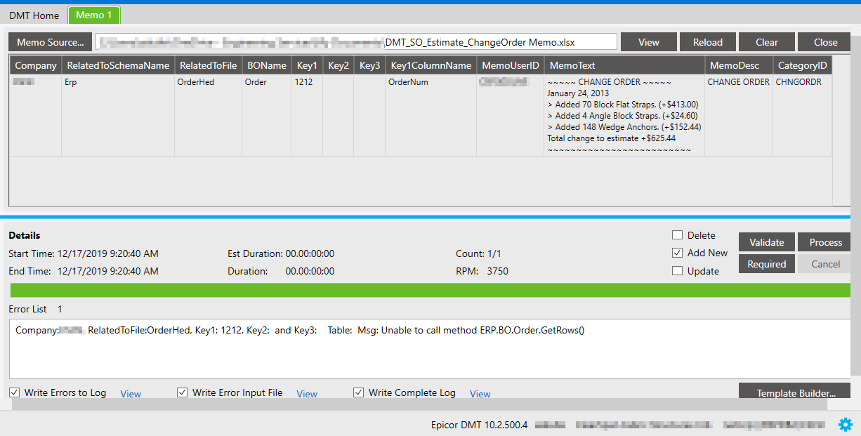

I’m trying to load memos to sales orders, but get an error of “Unable to call method ERP.BO.Order.GetRows()”
I added the two undocumented columns of BOName and Key1ColumnName (sort-of, it’s in the Required pop-up, but not on the templates, see KB0053316, yet it doesn’t show up when I do a BAQ showing the Memo table contents).
What did I goof up? Is BOName or Key1ColumnName supposed to be something else?
Neither show up in a BAQ of the memo table, so I’m not sure what to go on. They also don’t show up in the DMT Template Builder (but do in the Required Pop-Up box). See KB0053316 for this from 7 months ago… Maybe they’ll fix this in DMT eventually…
Aaron - Not at all The KB article mentioned the Customer memo’s used Customer as the BO Name, so I figured Order memos would have Order. Just got a response from Epicor, and the BOName is SalesOrder. Suppose I should have checked my BPM’s for that first!
EpiCare: “In the Memo import in specific, this column does not show up in the template builder as it is not part of the Epicor business object and you should add it manually.”
