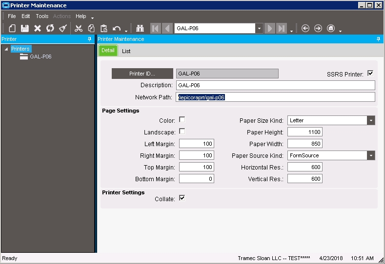

  2. Printer Setup from Printer Maintenance
The network path should be a UNC to a shared printer.
(i.e. \\servername\printername)

I pasted that path in to an explorer window and the printer queue came up, so I know it’s right. I also added the printer (mapped) the epicor server as TimShuwy suggested.

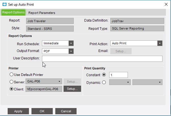

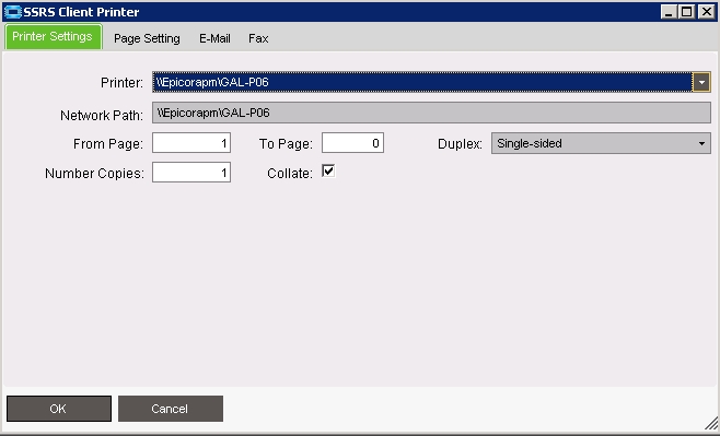

I thought for the heck of it I would try to use the client printer (screenshot attached) and it worked!AutoPrintBPMWorkFlowAutoPrintClientjpg
What gives? You can see the address in the client setup is the same I’m using for the server…

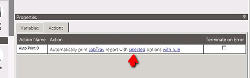

Click selected. I want to see the BPM Auto-Print settings, your Printer should be visible in there.
Is this what you’re asking for?
Set as Client (Works)
AutoPrint-Client

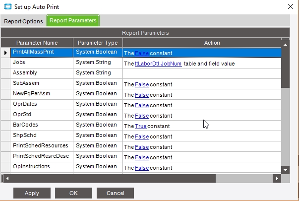

Yes and the Report Parameters tab.
Change your Printer to Server and pick GAL-P06 or “Use Default Printer” which will use the Printer the user has set under the Workstation if they have one assigned.
