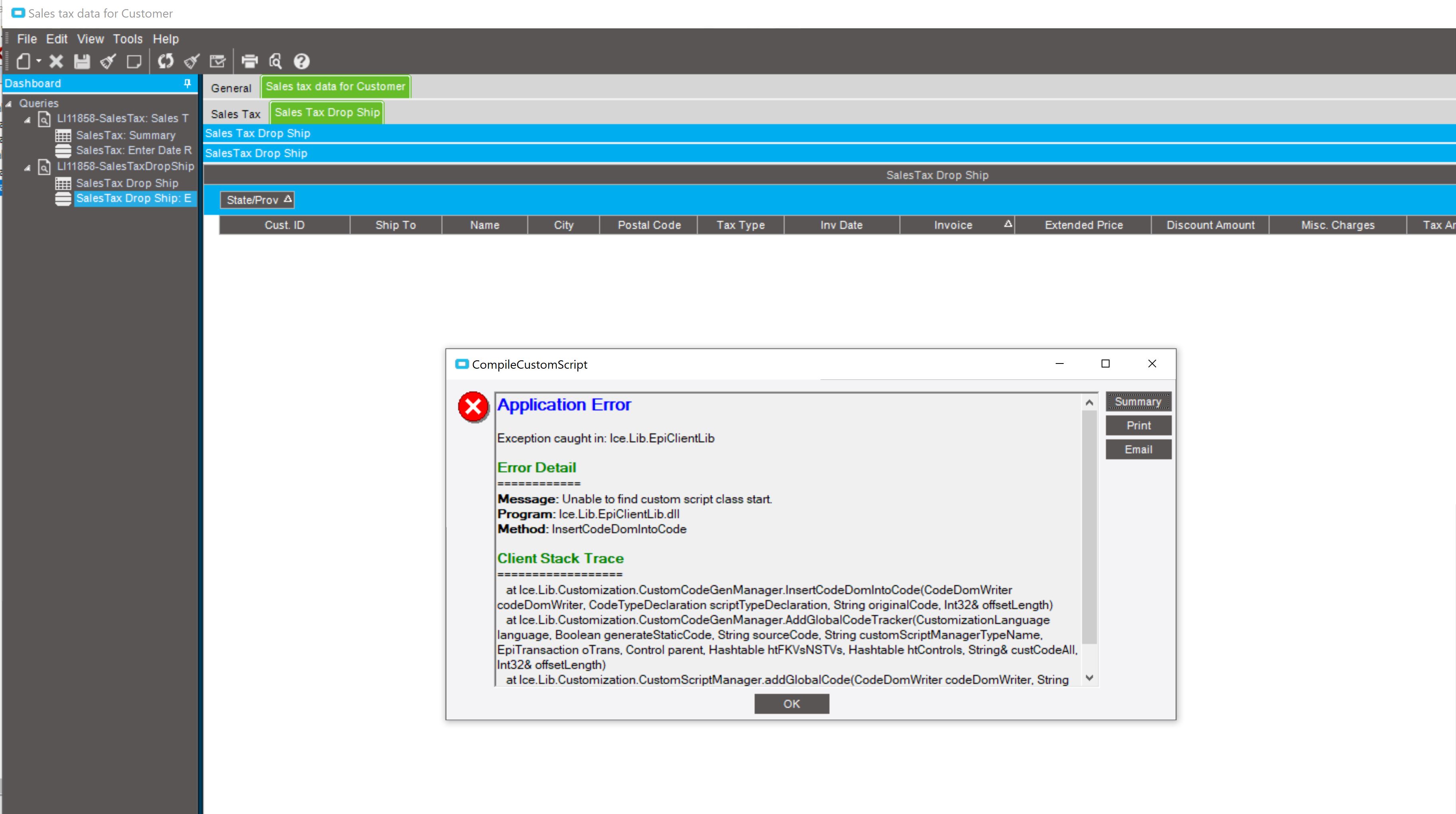

Unable to find custom script class start - Dashboard runtime error
I am uplifting this dashboard from Custom converted version of 8.03 to 10.2. There were a few syntax errors in the BAQ that I have fixed and the BAQ runs fine. But when I open the dashboard I get the error Ben Stohr in another post was getting (I posted there too but the thread is too old):
ERROR:
Message: Unable to find custom script class start!!
Program: Ice.Lib.EpiClientLib.dll
Method: InsertCodeDomIntoCode
I don’t think there are any hyperlinks being used in this dashboard so it is probably not related to hyperlinks post. There is another post on this issue 4 years ago, but I am unable to post on there.
I also don’t know where to look for code for Script class so I can check if there is any error in that code because there isn’t any custom coding that was done in this dashboard.
Any help will be appreciated!
Thanks,
Uzma
