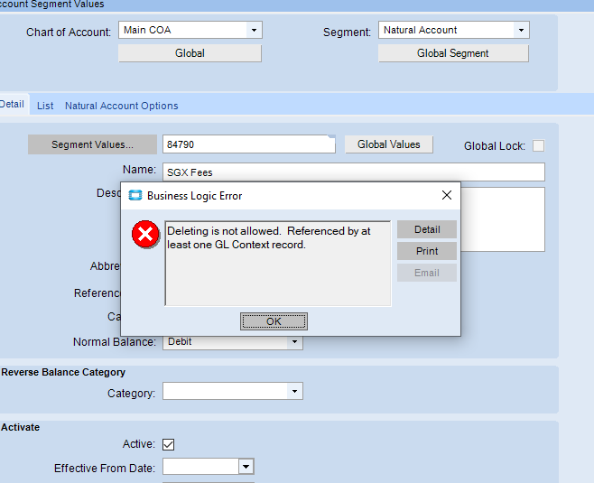

Hi all,
How can I delete a record in Account Segment Value? I have been getting this error message during deletion.
If any postings have been made to a GL Account using that segment value then it isn’t going to let you delete it.
But, if you only just created the segment then try these things:
  • check that it isn’t being used in “General Ledger Account” screen. If it is, try deleting that GL Account and then trying again with the segment.
  • if the GL Account won’t let you delete, then it has either been posted to or used in GL Control Code somewhere and would need removing from there
