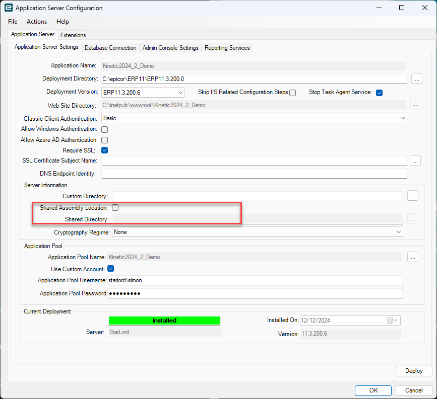

Typically the csf install has several components to install and one of them is the server side objects.
The system agent can be configured with rules to point to a specific application server.
If you have two app servers running then you would setup the Shared Assembly location to be enabled on the second installed app server.
The first app server you created you would install the csf on and then it should work.
If this is not checked then you are forced to install the csf on each app server, from the client on the server, which is what tend to do this for completeness.
You can read more about the Shared Assembly Location checkbox in the EAC help when you open up the Application Server Configuration.
BTW I have never installed the UK Csf only the Australian one, so there may be some installation differences.
I hope that helps.
Hi Simon,
Yeah we installed the CSF from the second App server and this seems to have worked.
