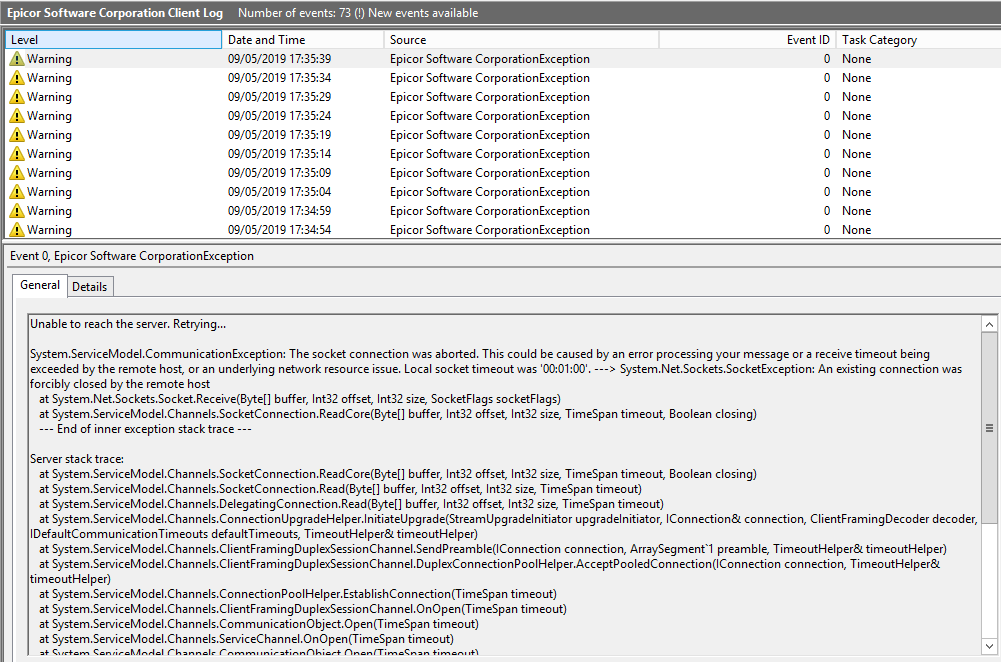

Install seemed to all go OK, no issues reported. The key menu item that it delivers is “Electronic Tax Reporting UK”. When trying to open this menu, the client flashes between the screen (which is now locked and unable to click anything), and a small dialog in the middle of the screen saying “Epicor is offline”:
I do have an open case with support (CS0001498305), but thought I’d reach out here to see if anybody else has had the same issue, or whether somebody recognises anything about the way it’s trying to connect. I spoke with the MTD Product Manager today, who said that it was spec’d in the UK and written in Russia. Also learned that the UI should be exactly the same as any others - if it’s a normal UI dll, I can’t understand why it’s saying that it can’t reach the server. All other UIs load and work as expected. To me it looks like this UI is trying to connect in a different manner (REST or Kinetic or something else I’m not even aware of).

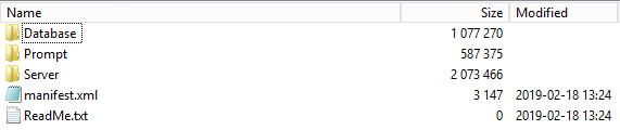

I solved it myself - found that it wasn’t copying some of the required files from the Epicor_CSF_UnitedKingdom_10.2.300.cab file to the relevant location the server.
Open the cab file using a proper zip editor - it should show the structure like this:
I had previously copied the Csfuk.data.model.dll file into Server\Assemblies because that file didn’t get copied by the installer. Picked up this as being an issue after installing the CSF pack, and being unable to save or edit a PO. CSF pack also has come integration for construction industry payment scheme, and so something gets added to the Vendor BO I think.
The thing that fixed the error with the screen flashing, and saying Epicor is offline was the BO files. Copy the CSFUK folder from within the Server folder in the CAB, to the same place on the server under inetpub folder.
You need to recycle app pool, then it should be good to go!
